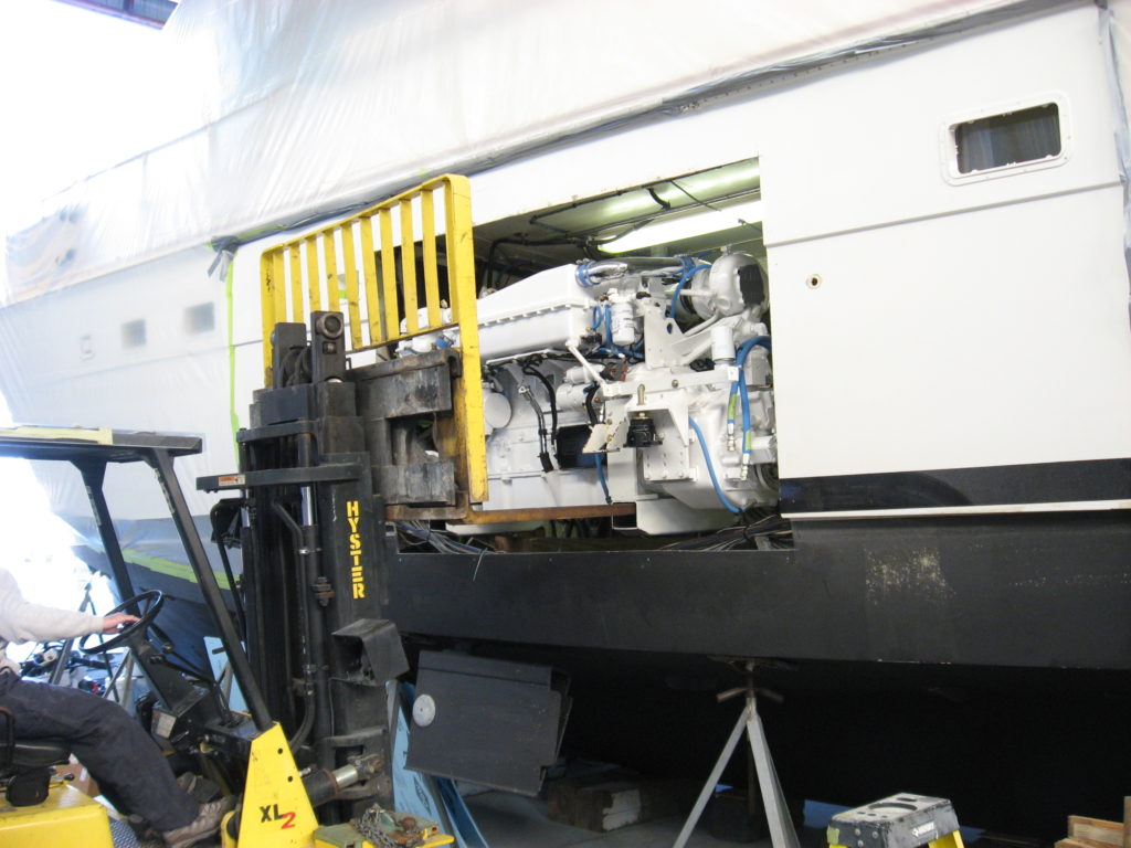

    I've heard of that before, forklifting out the hull sides. Easier than repairing interior decks and aft bulkheads. Had a 1979 Jim Smith that had double salon doors with large engine hatchs the size of the 12 cyl Mann's. We would roll back the carpet and remove hatches which exposed the entire engines for maintenace and cleaning. Seldom see that setup anymore. Engines could be lifted thru the salon doors.

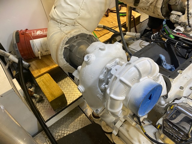

  4. Pascal
    8,947

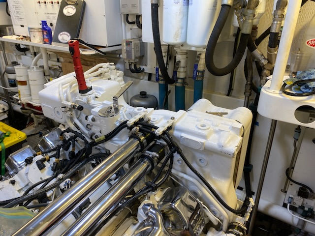

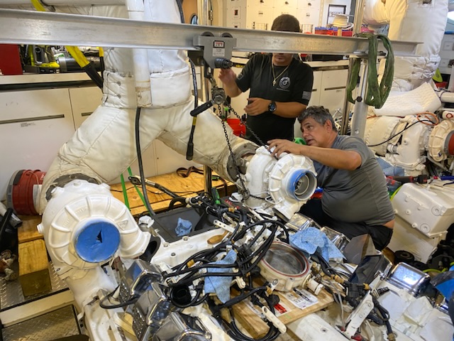

    Turbos are on

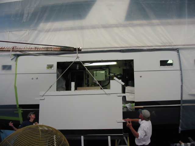

  7. Capt Ralph
    14,574
    Series 60 on da forks.
    Nothing else is this easy.
    It's that initial crunch the mind goes thru thinking about a big hole in your hull side.
    After that, it's smooth pudding.
    If your pulling both engines, most of the time, one hole works for both.

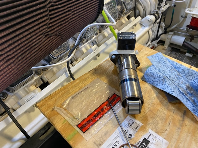

  8. Pascal
    8,947

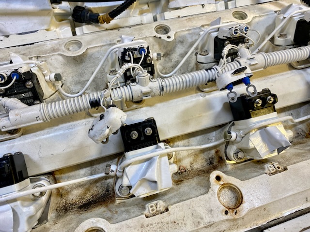

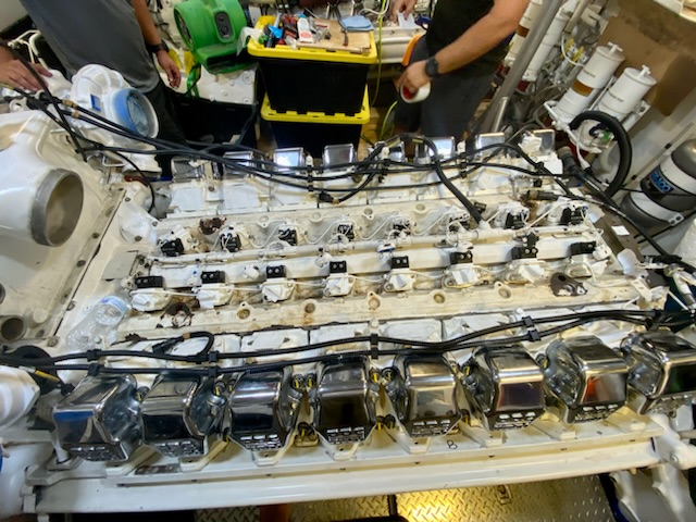

    Injection pumps going in and connected.

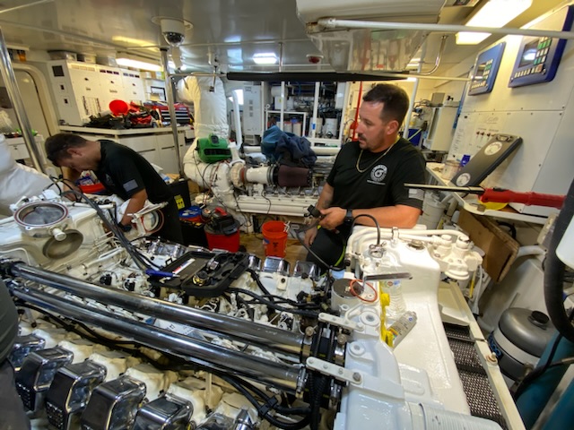

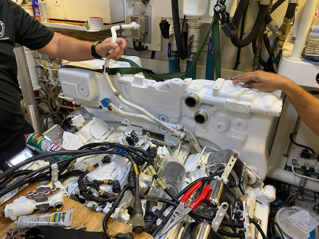

  12. Pascal
    8,947

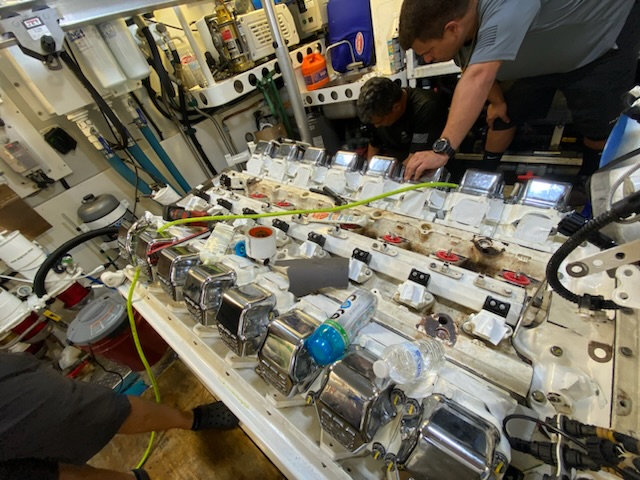

    More bits and pieces going in…

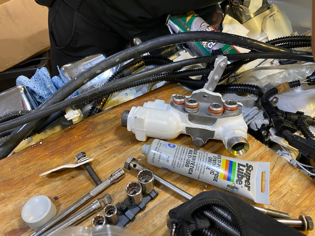

  13. Pascal
    8,947

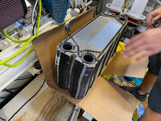

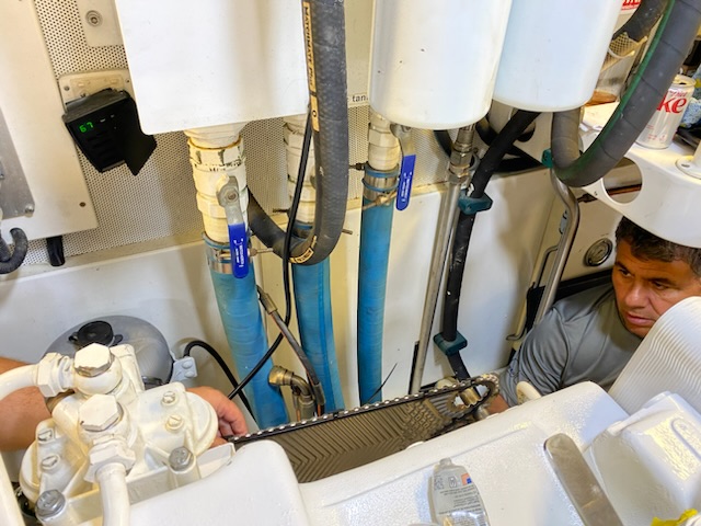

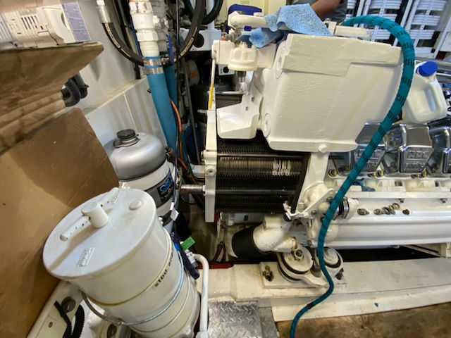

    Titanium heat exchanger plates going in today. Plates were cleaned and fitted with new seals. Cooling system was filled today and pressure tested (Last picture)
    hoping to finish the fuel plumbing, intake manifold etc on Monday along with alignment. Maybe able to fire it up on Tuesday and sea trial on Wednesday. Fingers crossed !
    I have a lot of video which I m putting together and will upload when it s finished.

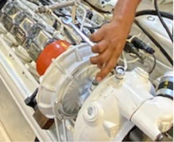

  16. mapism
    mapism Senior Member
    Aug 9, 2008
    2,297
    Sardinia

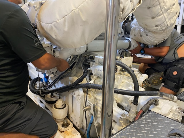

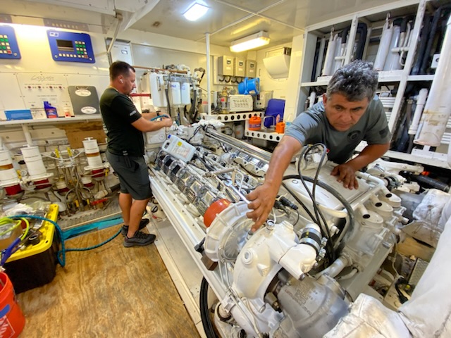

    Pascal, what's the orange bowl (sort of) behind the turbo, near the right hand of the chap in foreground?
    Just curious.
  17. mike Hartley
    mike Hartley Member
    Jul 22, 2016
    52
    nj
    Looks like a hose connector on turbo?
    Wow...alot of work.
    Looks like these guys are very good...did they do both engines Pascal?
  18. Pascal
    8,947
    That’s the hose which connects to the filter.
    they did the port engine last year, but that was just an inframe. Kits, heads, bearings etc. Didn’t have to replace the crank, and pull the ends. This one is a full rebuild
  19. Capt Ralph
    14,574
    Orange Silicone air filter adapter.
    Aug 9, 2008
    2,297
    Sardinia
    Gotcha, thanks.
