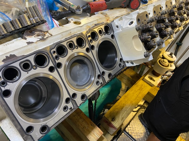

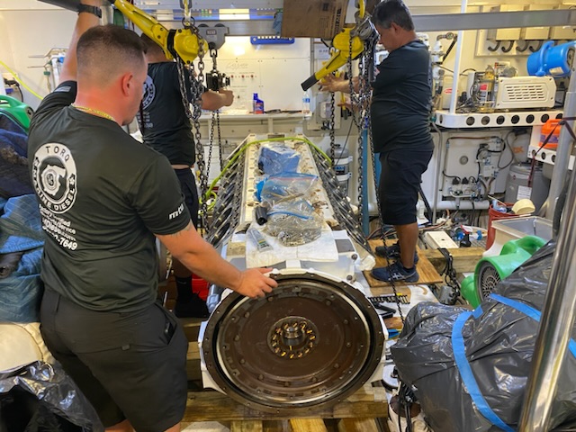

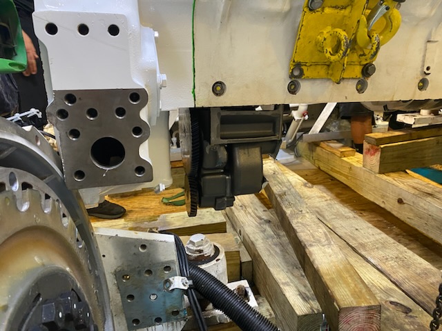

    It’s very clever ( space permitting) the guys have been able to rig a hoist to lift it , invert it , re rotate it back and block it off as they wish …..all in situ .
    Great thread btw .Pic threads always all Thx .
  2. Capt Ralph
    14,547
    Monster crank journals also. Note, not a lot of stroke.

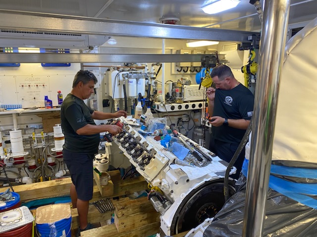

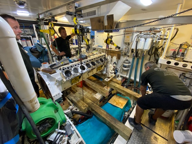

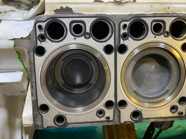

    Engine moved over back where it belongs and god bye list to starboard :). Oil pump on

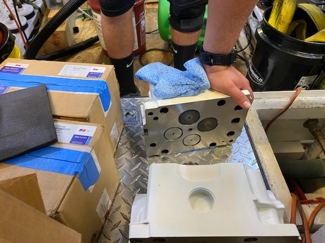

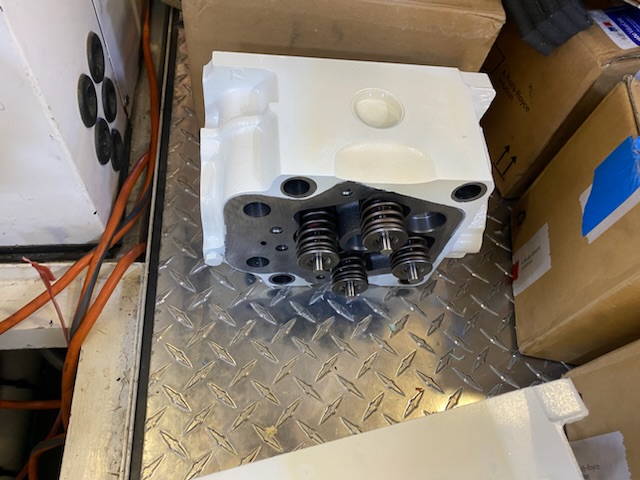

    Cylinder heads going on. All 16 of them.
