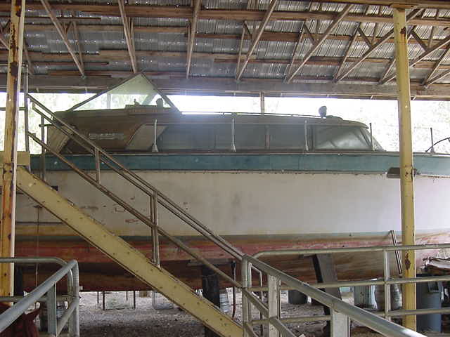

    Hello, all...i'm new to the forum and have just recently gotten a 1958 Roamer 35 :D .....been sitting in a barn for YEARS!!!....i am going to move this boat myself, roughly about 300 miles, as i have a 53' flatbed lowboy trailer...there is no chance of crane service as this boat is sitting in a barn perched on 6 R/R ties driven 3' into the ground......weight has been spread out well and the hull checks out fine...my question is how do i go about supporting it on the trailer ?...i have thought about some dock foam cut to fit tightly around the boat as i have seen this done many times...there are no engines, ect in the boat currently and i have gotten all the oversize permits i need...any help would be great!!! thanks...Tim:D

    This sounds like it may be an interesting transport. I'm curious to know how you intend to move the boat from it's current "perch" to the trailer?

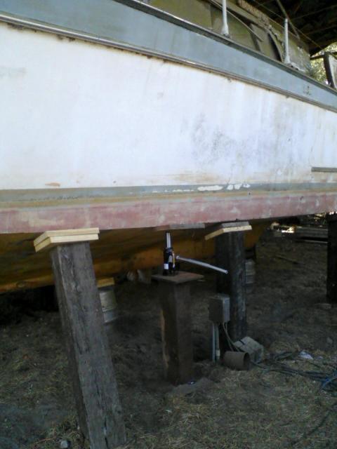

    thanks for all the good info as it sits, the trailer is about 8.5' wide and as you all know the rear is about 10' wide (total beam measures 11'9")..the "perches are wide enough to allow the trailer to go right under the boat....i am going to make some "Perches" out of 8x8 box steel with plates on either end...weld them to the trailer and strap the whole thing down...i will fab this stuff at the load point (not at home) so we're going to take a bandsaw, welder, steel, wood cribbing and 4 "I" beam posts i made to put the bottle jacks on (About 30" high)...i will try to post some pics of how the boat is currently stting on 6 R/R ties (think...drove 2' into the ground 3 on each side)...what are the opinions on my plan?:confused: :eek: :D Tim

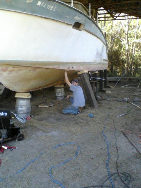

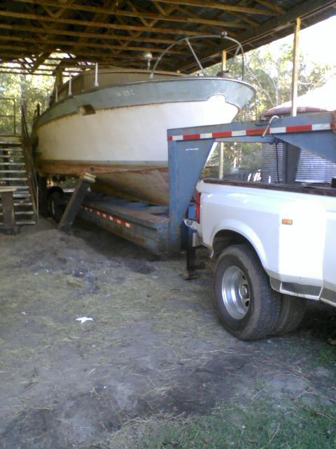

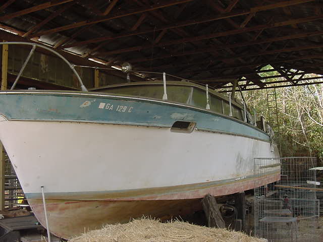

    well, i didn't have it laying around, but i did get 2 10' sticks of it for free.......i'm just hoping the DOT doesn't decide to give me a whole lot of grief........aside from that, i plan on blocking it up at the house in a similar fashon, although, i'd like to have some weight on the keel.....i almost got sick when i saw this boat sitting on just 6 R/R ties with just a few beer kegs under the keel loosely..... BTW...a few pics that i had promised....

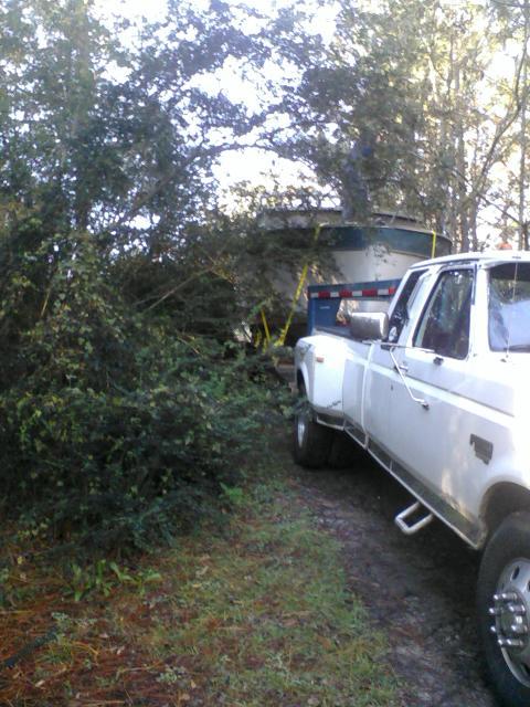

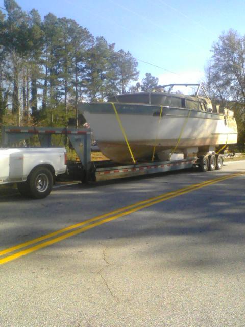

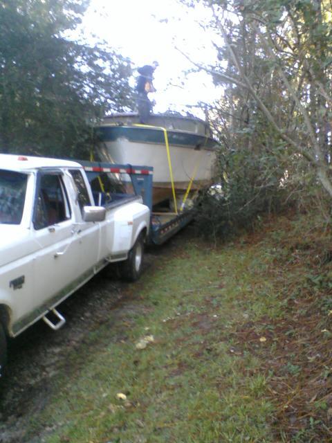

    Ok, well managed to get home to South Carolina safe, and ticket-free...by the Grace Of God, the weigh stations were closed....how?...don't ask me!...here are some pics.....

    We had to chainsaw the overgrowth since the boat had been put in the barn years ago.... I took this pic as soon as i got home and out of the truck....BTW...i must have passed 11 state troopers in Ga. and not ONE gave me a second look....i bet if i'd not had the permit, i would have gotten pulled over.....my luck....LOL...now the cleanup of chicken poop (yes there are eggs in the sink in the head), feathers and spiders starts.....BTTW...the Previous owner gave me ALL the orig paperwork for the boat...including the orig order, build sheet, and a photo from (i think) 1958 from a yachting magazine in which the orig owner did a photo shoot...the boat, at that time , was named "Christie II"....really neat stuff....flyers from CC for all the Roamer models.......

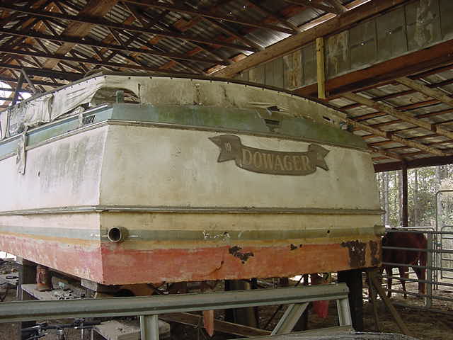

    some pics of the orig owner when "Dowager" was the "Christie II"....Thank you, Eric...i will try to have the hull # for you in a few days....i'm going to have Pizza and a beer!
