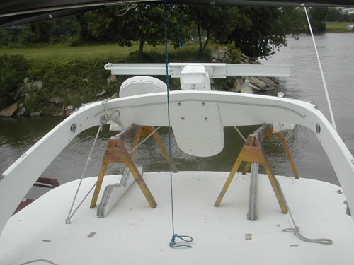

    The flybridge has to come off while transporting on a trailer. It's not that difficult to do. Measure it from the hardtop to the ground. That will be about the height of it on a trailer. Then get your quotes to have it transported.

    Before you remove the flybridge be sure to run several pieces of tape from the bridge to the roof and then cut them to help you line it back up for reassembly.

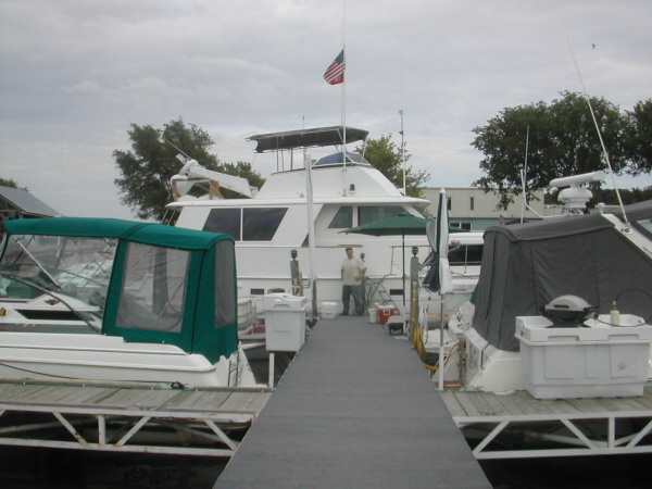

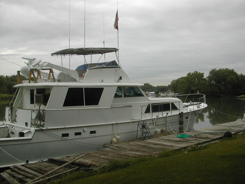

    After seeing the pictures, that's an easy bridge to take off. It should take 2 guys 2 days to get it loose and ready to come off and a crane to lift it.
