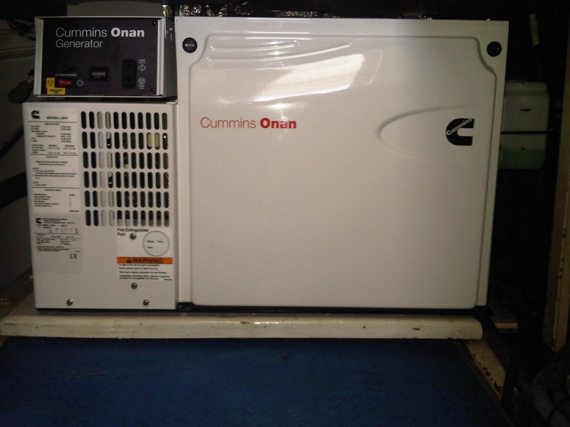

    Will take some pictures tomorrow, I have the 9KW MDKBL with sound shield, and I was a little surprised that it looked inside quite similar to my old 1992 one!

    I am also in the final stages of installing a new Onan 9kw unit with sound shield. I will be intersted to see how much quieter it is.:)

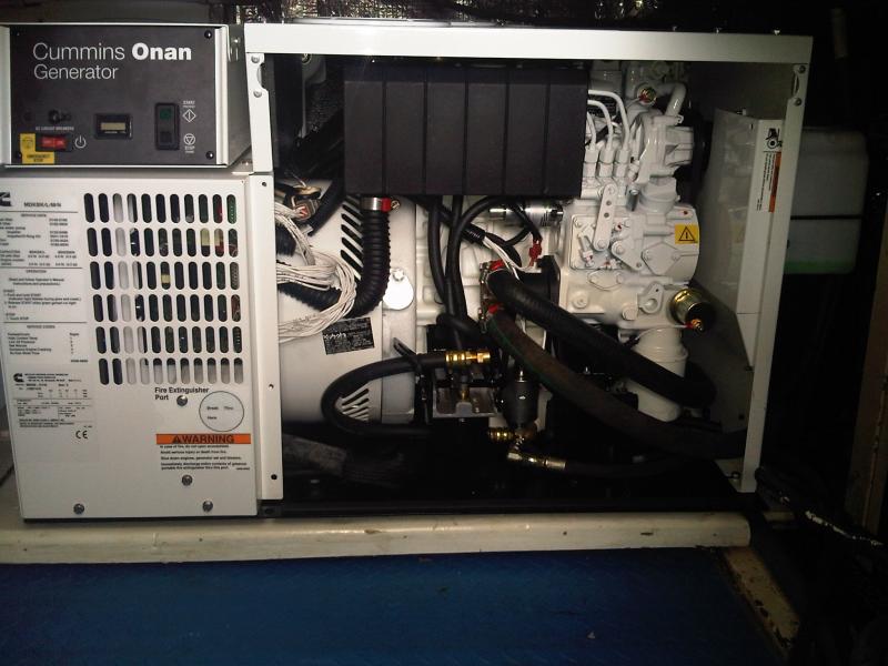

    Finally some pictures
  9. Capt Ralph
    14,577
    21 years later, your first Genny had a long and good life. RIP.
    New stuff does look like old stuff;
    Updated Kubota engine. Real clean exhaust.
    Updated OhNo electrical end. Fancy AVR and a block of saftey relays.
    It is a way better, stronger, cleaner unit. You should be very happy for years to come.
    Congrats.

    Erik, the new genny looks great. It looks like you re-used the original wood mounting, it looks like a simple swap out. I wonder if you will have enough juice if you wanted to go to a bigger a/c in the salon. I am thinking about a new genny; but I want to go to a 24k a/c, I am not sure if the 9.0 can handle all the lights, all a/c and few other things at the same time.
  12. P46-Curaçao
    P46-Curaçao Senior Member
    Mar 8, 2013
    734
    Hi Ruby, yes I re-used the original wood mounting, it was still in very good shape, and removed it, and repainted it. The swap was not too difficult, had to change the fuel line connector and re-route (actually renewed it) the battery cable. Off course we renewed all hoses, clamps etc.

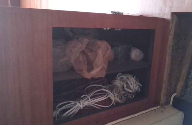

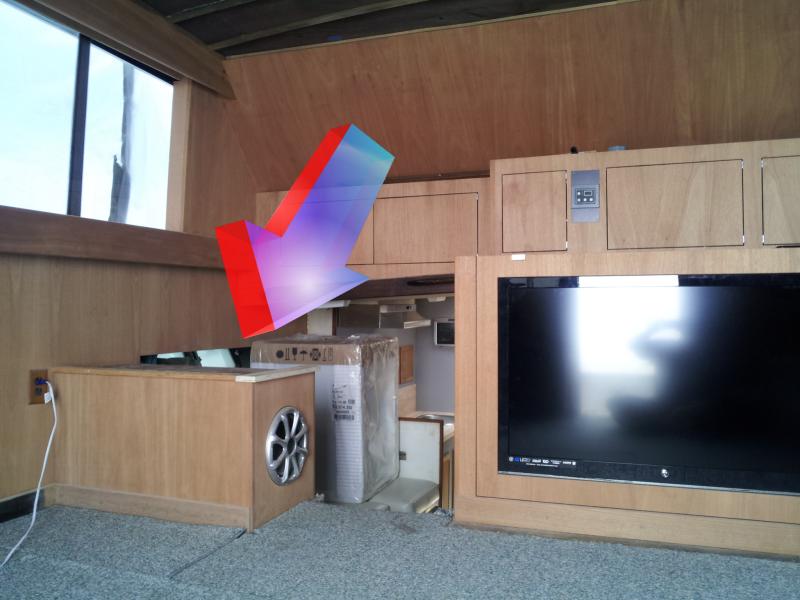

    P46, just curious where you mounted the 3rd ac unit again between the saloon and the table? Would love to see some pictures as I have often thought about where I could put a 3rd unit? How about the intake? Are a 3 on one pump and intake or did you add extras?
  14. P46-Curaçao
    Mar 8, 2013
    734
    Hi Kubu, I only have some old pictures, but I put it in this cabinet.
    I made an outlet on top and electricity, and water comes thru the engine room.
    We made an extra inlet, strainer and connected the a/c to the existing outlet.
    I still need to find a vent cover for the whole air intake section, or I buy a smaller one and make something to measure.
