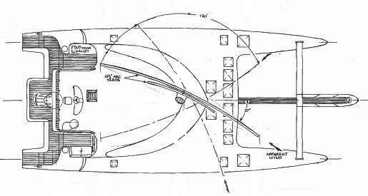

    I'm sorry Ekiqa, I misinterpeted what you were asking I guess. I thought you were looking to REALLY modernize the square rigger to the same degree that Falcon has done, but in a more traditional look.
    I'm assuming you mean in spar furling for all yards or yardarms. This is nothing really new, I'm sure many modern square riggers have this feature. Problem is the yardarm spars must be straight and thus do not impart the ideal shape to their sails for any windward work
    I'm confused again. Are we talking swiveling spars, or rotating spars?
    I assume we want to have the rotating spars (yards) in order to furl the sails up....this can be done hydraulically.
    Then are we to have the swiveling function controlled by hydraulics as well? The lever arm forces here are significant, and for each spar (yard)...LOTS of weight in this rig
    With these spars both furling and swiveling under automation things get pretty heavy up top
    No problem
    The rig has to be optimized in its aerodynamics to be capable of good windward ability. If not, no amount of keel will help you, but only slow you down. This is the single biggest step forward with Maltese Falcon.
    First, the sail shapes are optimized by the 12.5 degree arched yardarm spars that control the camber of the rectangular sail. I'm not sure I know of any other arched spars on square-riggers??
    Secondly, the free-standing carbon mast of Maltese Falcon allow for the yardarm spars to be swiveled (rotated actually) around much further than with the traditional square-rigger where the rigging holding up the main mast does not allow the yards to rotate to this degree. This means we can orient that 'cambered sail-foil' into the apparent wind in a much more advantageous manner...our pointing capability is MUCH improved...we can now go to weather in a square rigger!
    You could put a 'traditional' looking hull and deck under a free-standing square rig sailplan....??
    Note the rotation here with the Dynarig...thru about 130 degrees...no 360's

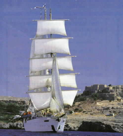

    How about this one
