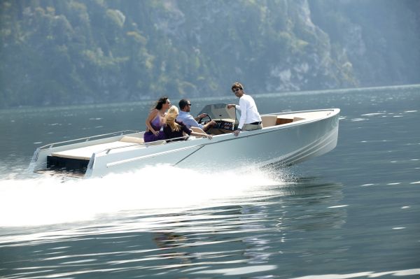

    Nice looking retro center console:cool:

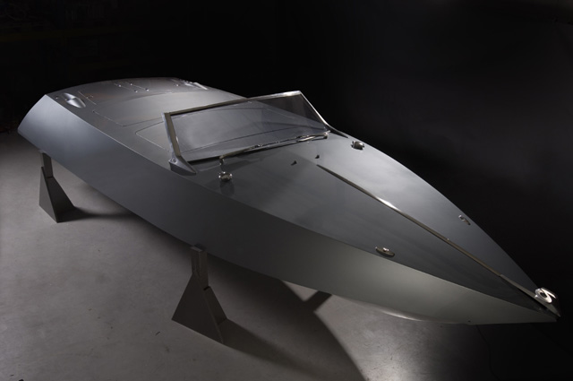

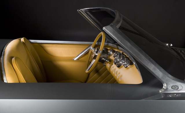

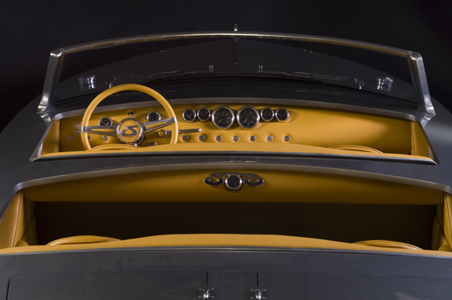

    SivestriS production version
    Here are a couple of the official images of the new SilvestriS 23 tender.
    It should do about 50 knots, but the best feature is the remote controlled lids that close it of. No more dirty hands or wet feet while closing up the interior!

  16. Kevin
    3,112
    Love that last pic!! You almost wouldn't think it's a boat! :)
  17. Yacht News
    31,065
    Yes that is very nice looking ....That would look very good on the former Alpha IV or mabe Siran...;)

    Loosing sight of the thread
    As an Engineer working in the yachting industry I think some of the above tenders are slightly odd choices as a 'Yacht Tender'
    What we are looking for is something that is safe, comfortable and dry!
    A Yacht tender should be capable of getting guests to shore in their dress clothes, without a wrinkle or damp patch.
    They will be driven by a young deckhand, so need to be easy to drive and park alongside a yacht, often with a big swell. They will be rammed into topsides, docks and up beaches.
    Lastly they need to look reasonably smart so as to impress, as the tenders above do.
    These latest tenders look awesome and do indeed fulfill the impress bit but I feel that if you get them away from a lake, they would struggle to stay good looking for long.
    The guests would be impressed until the first spray soaked their new ball gown, and the deckies would love driving them until they had to moor alongside an anchored yacht in a bay with a swell. The second job after stowing for the first time would be to repair the chipped paint and get the engineers in to fix the automated hatch which has failed due to sea water ingress.
    Realistically you need a rigid hull with inflatable tubes (built in fenders) protected props and good build quality. then try to find a good looking one.
    For me, a custom RIB is the best choice.
