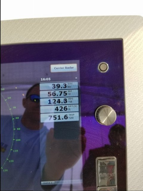

    With 1600hp pushing 35k to 38k pounds the engines are not working very hard and I have not yet seen a WOT test that didn't have both motors exceed 2350. With that said I have only owned the boat 1 yr. I only post in an effort to learn as much as I can from you guys and am not trying to prove anything. As Pac Blue eluded to as well the PNW has very little growth in our cool waters and on top of that I keep the boat in an enclosed building so the only fuzz I have to knock off is the transom every month or so with a brush. The underwater metals have propspeed or some other similar coating that is also working as desired. Here is a pic from a fishing trip prior to haul out. I don't have any other photographed results but I do have seatrial from when I bought the boat and when it was commissioned new by MAN. I have compared the computer data from both commissioning reports and they are nearly identical to today across the board.
    Old bottom paint August 2017 2352/2372
    Sea Trial Florida Oct 2016 2350/2365
    Original Commissioning Data - New Boat 2357/2377

    I agree completely. 37 knots is with neutral conditions. Attached is a pic from previous trip that had a nice current going with us. 20170806_160701 (Small).jpg

    Oh boy, 39 knots (with a little push), that is really honking for a 40 Cabo Fly!
