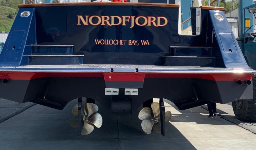

    To much unsupported shaft. (?)
  2. Cowger
    Cowger Member
    Nov 14, 2019
    47
    Sacramento, CA
    Thanks for this feedback. As I'm trying to learn about this stuff... what's considered to be the proper amount of unsupported shaft? Is this something that could be corrected?
  3. Capt Ralph
    14,574
    I was just guessing but looking at those massive wheels and the skinny shafts brought this to mind.
    One bearing at the propeller and a floating hub in the engine room could lead to some shaft fling.
    I am not a heavy in this, just know enough to ask.
    Fixing it if I'm close?? Cutting off those ugly bilge keels and installing new struts and bearings correctly placed.
    This may be the reason so many of these boats are for sale.

    Hmm, okay, I'm obviously confused. Too much unsupported shaft... does that mean "unsupported beyond the cutlass bearing" or "unsupported in those vertical fin things"???
  8. Capt J
    14,897
    I think he means too much unsupported between the shaft log and the strut, which is encompased in those vertical fin things.
  9. Capt Ralph
    14,574
    Unsupported within those fin things.
    The shaft is not supported inside of those fin things until the cutlass just before the propeller.
    There is a science that spinning shafts cause drag. A whole stabilizer system has been designed on this Magnus Effect principal; spinning shafts or cylinders in the water.
    Some even go so far to seal the shaft way and fill with oil between the struts. Seems like a C F to me.
    I have yet to see any benefits but I am just a mild swamp tech. Others with higher pay scales think it needs to be covered so it is there.
    The additional thoughts to the bilge keel design; Those fin things; helps the directional water flow AND acts like additional keel surface area.
    IMHO;;; B S..
    More wetted surface drag and reducing natural clean water to the props.
    Again, I have to repeat; I am just a mild swamp tech.
    But if it looks like B S, acts like B S, Vibrates like (just) S, then it must be the reason that many very fine Marlow Yachts are for sale cheap, Law suits (buried issues) have been settled and your asking.

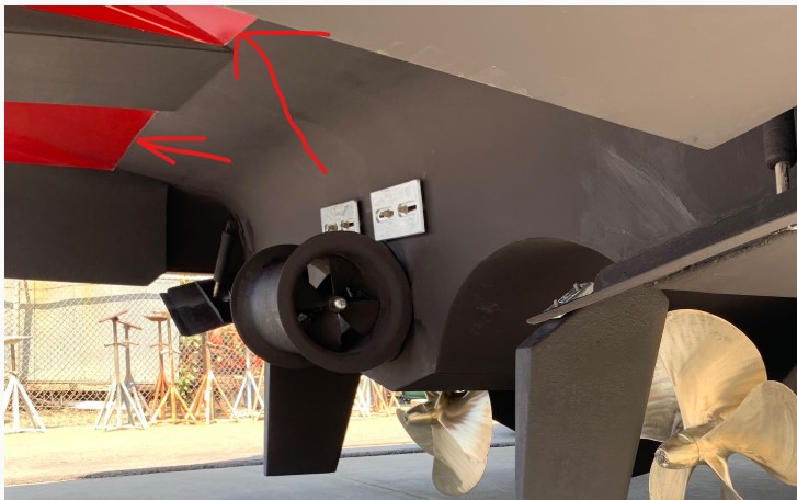

    If it were me, I wouldn't go any further than you already have. If you're insistent on moving forward, I would pay what I needed to pay to go on a seatrial at cruise speed in a sea, check what vibration there is, go in the engine room and look at the engines and shafts and see if they're smooth or jumping all over. Also a big issue with that boat is the height of the swim platform above the water. If you are at a dock or anchored and a 6" or larger wake heads towards the transom, it has nowhere to go, stuffs underneath the swim platform and the entire boat shudders and water shoots up straight in the air as high as the FB deck and gets the entire aft deck. I witnessed this at Charleston City marina when one was outside of me.
  16. Capt Ralph
    14,574
    Can you expand? No vents in the back porch??
    That is new to me. That does suck.
    Even my 42 year old (last month) Bert has wave vents in the back porch (platform).
  17. Capt J
    14,897
    Look at post #86 on Page 5. No vents, the water rolls perfectly under the platform which is enclosed on the sides and has no vents and has nowhere to go and shudders the entire boat and it shoots up 10' high at the edge of the swim platform, sometimes rolls over the swim platform..........I've never seen anything like it. I could see the boat shuddering from across the dock on my boat.
  18. Capt Ralph
    14,574
    Yes, I notice the angled up area painted in red.
    Did not think about a vent then but now, must be one hell of a compressed sneeze from under that platform.

    I agree that the view of the stern from this angle makes it look like wakes from behind hit two non-vented pockets:
    But from this angle, the forward end of these pockets seem to be pretty gently angled downward -- would the wave energy not simply be pushed downward? I'm having trouble envisioning how it would be "sneezed" backwards or upward.
    Please note that I'm only continuing to consider this boat as many have stated that each Marlow is different and needs to be evaluated on its individual merits and faults. I haven't been on her yet, but am scheduled to do so this Saturday.
