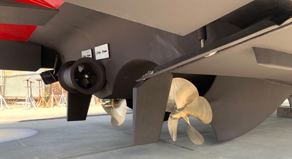

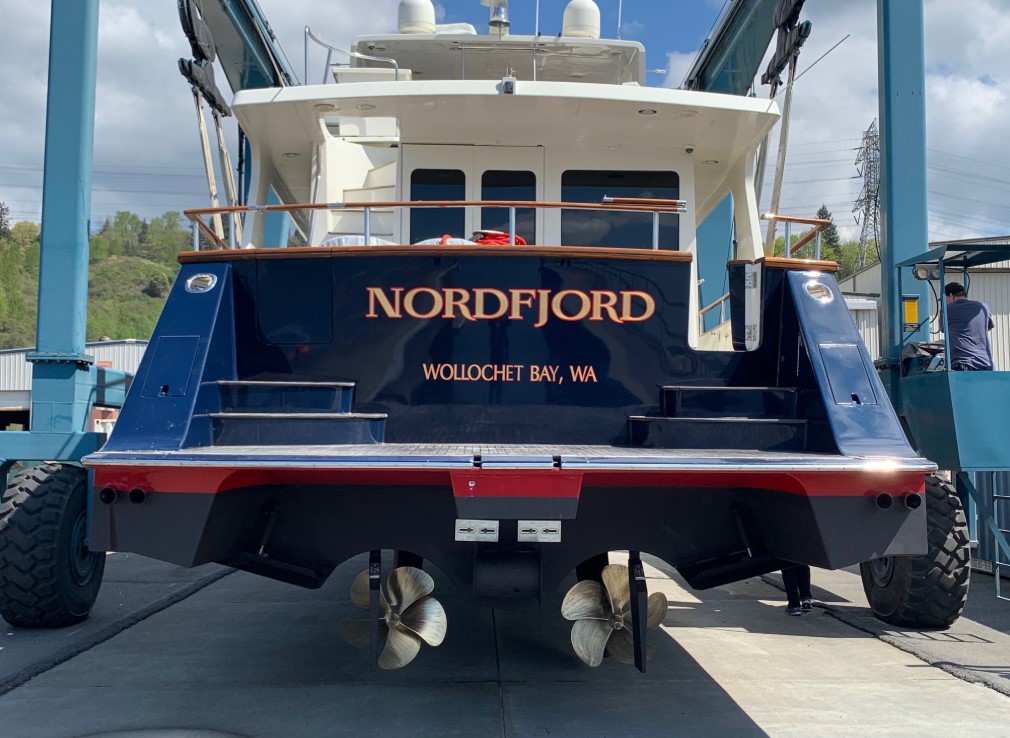

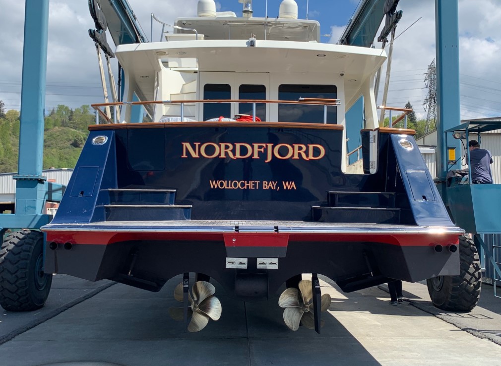

    Digging up a very old thread, sorry, but this was a fascinating read. What got me here is I am looking (online) at a Marlow 70' and am wondering if I should even bother to consider her at this point.
    Here are a couple pictures. The props seem small and rather closely spaced, but don't seem to have the problematic tunnels mentioned in this thread. Not sure where the exhaust ports are (that lead to the cavitation / vibration mentioned above). The two ports on either side of the transom at waterline seem too small to be the main exhausts.
    Thoughts?
  7. Capt J
    14,897
    I would say those are problematic tunnels. You have whatever those giant things (shaft tunnels) are that the shafts are encased in, making the water veer away from the props and the props trying to suck the water that is flowing around them versus just a shaft and normal small strut. The thing sticking down in the first photo, is the tail end of exhaust deflectors, which in my opinion are a bandaid for poor placement of the exhaust.......

    Yes, now I see the tunnels very clearly. Thanks. Moving on...

    One thing to consider, not many boatyards out there that are familiar with their design and knowledgeable to repair drive train issues. Those exhaust deflectors were added after the boat was built, must have had some exhaust related vibration issues related specifically to their design.

  11. rtrafford
    rtrafford Senior Member
    Jul 13, 2019
    1,991
    Vero Beach
    Wow, first time seeing this build out of the water. The prop placement reads of a cyclops. Even with the tunnels, how can those props not impact each other with wash?

    No kidding, stabilizer fins, underwater exhaust, tunnels, shafts running thru velocijet struts keels, rudders, and trim tabs. If the stabilizers or trim tabs are not operating properly you will get exhaust in a tunnel with vibration limiting speed. Parallel alignment of shafts and velocitjet strut keels could cause an issue too. Complicated design.

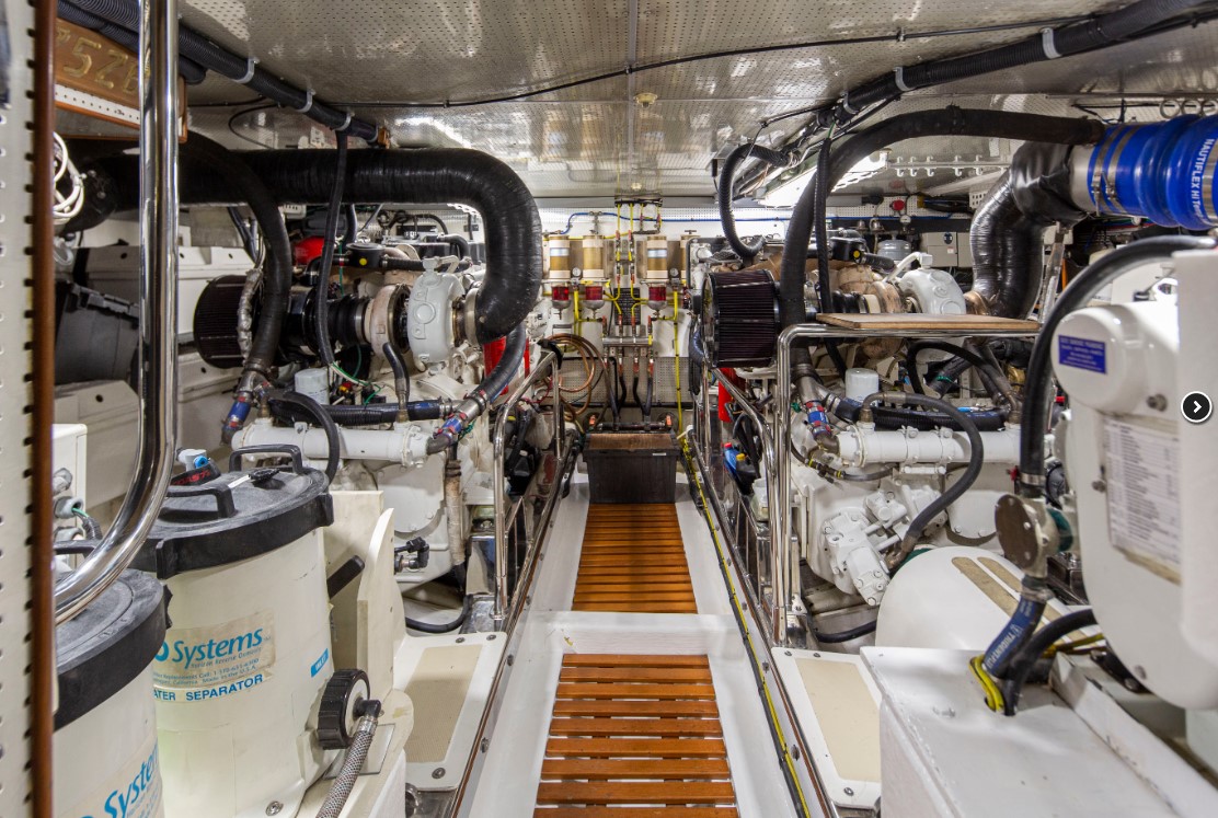

    I can't mention the boats name but it was a tall Marlow the owners loved. In the engine room, I could play half court between the in line Cats.
    I have been studying that last bottom picture (post 86). These engines are way closer than the Marlow I was working on.
    Was he looking for more dense water or a different ER layout when he brought the engines closer?
    I can imagine NO room between the blocks per these pictures.

  17. rtrafford
    Jul 13, 2019
    1,991
    Vero Beach
    I've always enjoyed looking over Marlows at the dock. This Marlow on the lift, however, that's a cacophony of nonsense underwater. Those props so close together, neither with even the slightest opportunity to grab clean water...

    The one we sea trialed had a decent ER. The crew quarters in what is normally the lazarette was a different story. It was crowded and limited access to hull and equipment. The "Throne " as they called it (the head) sat over the Rudders and trim tab systems had very limited access. This was a early 2002 model, no telling what changes they made later. Seems to always be a lot of them on the market.

    Engine room of this particular boat. Cat 3406Es. Doesn't seem to be too bad, but I'm still not clear why the props are so close for a boat with an 18'4" beam.
  20. Pascal
    8,948
    I guess you Really need a stern thruster with the props being so close!
    Lazzara used enclosed shaft housings on the C30s powered 84. They are supposed to reduce drag but Probably not by much since they didn’t use it in the C32s with larger shafts.
