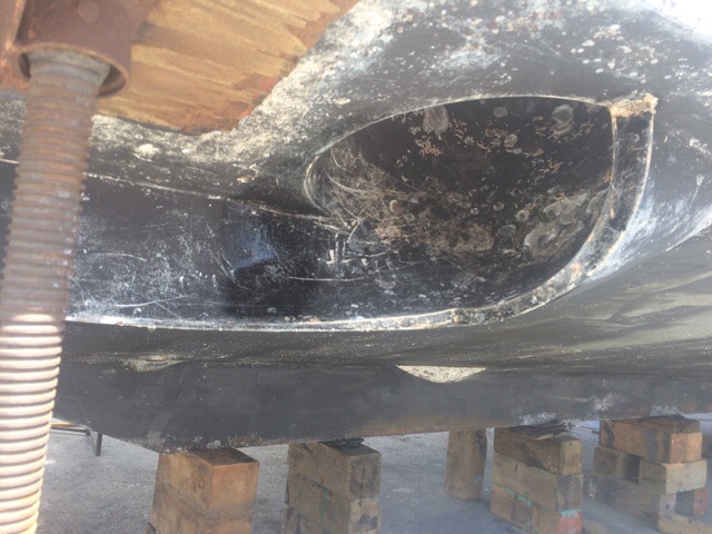

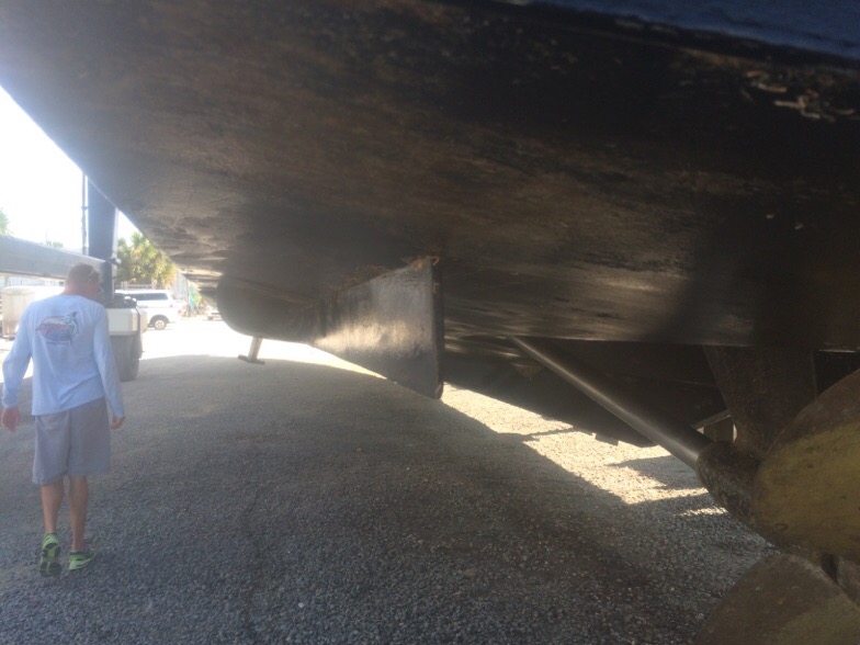

    I ve been running an 84 lazzara for about 6 months now, with the fences, and cavitation or exhaust gases aren't an issue as long as you don't jam the engine control forward. On sea trial the rent a cap hired by the seller did just that and indeed the vibration was horrendous. With the C32s the boat gets in plane at 1500rpm / 17kts and 38% load so i usually add 100rpm every second from 1000 to 1500. 5 second total... common sense

    That is some good speed @1500 on a 84. I can imagine those C32's are digging hard when accelerating fast. I do remember the capt going full throttle from about 1800. Not sure if that created the problem. The boat was 100 rpm from turning the 2300rpm by cat specs. Are the fences you mentioned similar to the faring buildup on the leading edge of a bow thruster opening?
  15. Capt J
    14,645
    Yes they're a 2" thick and deep lip they glass halfway around the center side of the exhaust opening and then run back the edge a few feet. Quite honestly I would be looking for another boat. I would be buying a boat with majoring engineering issues from the builder and also poor business ethics from same builder. A 64' Hatteras MY is another option, they're fast some cruise at 28 knots but you can dial them back to 20 knots at 100 gph, or 10-11 knots at 15 gph or so. A lot less exterior maintenance than a Marlow or Fleming. The Offshore I ran was right around the same size as the Marlow you seatrialed.
    Here are some pics of the fence on the 84. I may be able to accelerate faster but never do because of passengers and stuff around the boat. I just don't see the need to jam the engine controls forward and stress the drivetrain for no reason.

    Pascal, your 84 has good performance and fuel burn. Thanks for those pics, never seen that fix. Interesting. Sounds like it cured your exhaust problem. Is this a common problem with underwater exhaust?
