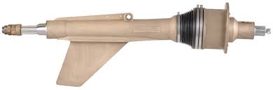

    We ve been looking at a couple Mangusta 72s. Reported cruise is 34kts. WOT 40kts and economic cruise is 31kts at 90gph. That's an amazing cruise speed and economy.
    So how does this boat handle goi g down the inter Coastal? If you are moving the boat 800 miles north what would you cruise at?
    What else to watch out for?

    I haven't driven with surface-piercing drives, but out of engineering curiosity I've done some reading about them.
    Fully submerged, the large diameter props put a lot of strain on the engines and drive trains. Not a problem at hull speeds, a bit inefficient, but not putting out a lot of power anyway.
    From hull-speed to cruise-speed, water is covering or mostly covering the props, they are sometimes cavitating sometimes not, sometimes in foam and sometimes in clean water. The drives and engines and drive trains are not happy, not efficient, and working very hard whenever the props are submerged, lots of rpm surging. The ride is similarly not a happy one, lots of vibration and surging, alternating asymmetric thrust can make it a wild ride requiring a lot of steering inputs to maintain course as the props are in different flow environments.
    During a hole-shot start, the props quickly cavitate, rev up to speed, and start grabbing water at the blade tips for acceleration. It isn't smooth, but it is predictable, symmetric, and short duration.
    They suck between hull speed and cruise plane. Slowing down a bit when going gets rough is not a good option.

    I'm not a fan of surface drives. However, properly installed on a good boat, they're not as bad as you're describing. I have driven with them on a Pershing. Their design purpose is speed and they provide it very well. Typically they don't plane until you reach a speed of 20-25 knots, then you might back off just a little and stay on plane. It's that awkward area between 8-10 knots and 20-25 knots where they don't handle or perform as well. During that period the drives are submerged and less efficient. Holding a line is more challenging. Now, as to cavitation, that's going to depend on the boat and the installation. I did not experience an issue with it on the Pershing, but my time on it was very limited. We do desire a faster boat one day and most do have surface drives. However, that's not personally our choice. We'll probably go the route most wouldn't and go for jet drives.

    Downsize is that they need servicing more then shafts and you need to be careful on the anodes.
    Advantages is that if you hit something with the propellers it is very difficult you sink. Maneuvering is not as bad as they say.
    If you touched 40 knots then the 72s you are seeing has the 1550hp which is what I would suggest on the 72. 1300hp Man are just okay and would give 35 knots WoT.
    Lovely boat and if in good condition is still one of the best 21 meter hard top boats ever designed. Again a design to Stefano Righini, who tend to have some of the Viareggio area builders under his belt.
    The problem with most jet drive yachts in this size is that most of the designers tend to go a flat Vee hull aft, which tend to make them less sea worthy at the speeds they need to go. The exception being to this was the AB Yachts, but for example the Arno Leopard as the 24 is flat low Vee aft.

    Woow, Maintenance???? Near zero (jets) vs mega bux yearly (surface drives).
    Think stern drive gimbal boots and then let your nightmares begin.

    Yep, you will have boots also.
    In warm water, nearly every year service. Careful dive service every month.
    Oh, boots, bellows. Big black rubber (expensive) things.
