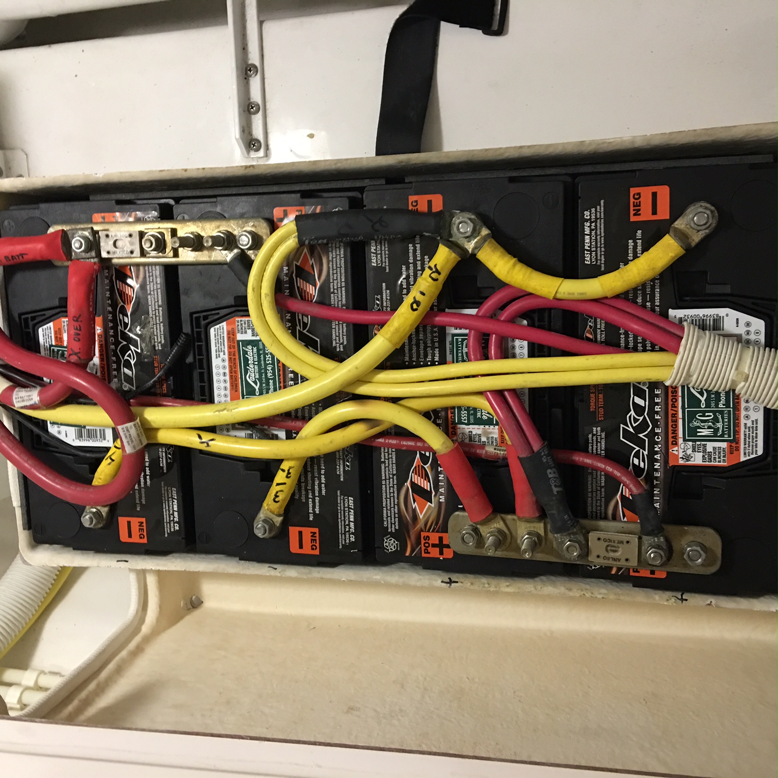

  5. BoulderGT3
    BoulderGT3 Senior Member
    Jun 19, 2014
    168
    Ftl
    K1W1- Apologies for the typo on my end, typing on a small screen.... 4 batteries on each side paired up to get 24v. I just replaced them a month ago. It came from the viking factory with this configuration instead of 8d's. I've not computed CCA comparisons as it's always worked well and they are easier to handle. I've never had to go to dual even when the other batteries were end of life. IMG_0215.JPG
  6. Capt J
    14,434
    4 Group 31's should have plenty of CCA's to roll them over. Call a MAN dealer, but I run a boat with 1100 common rails and 2 group 31's fire it off and was how it was set up from the factory.
