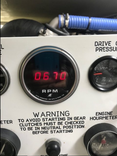

  12. Lunderic
    Lunderic Member
    Sep 6, 2018
    125
    Oceanside, NY
    yes they are permanently wired digital tachs in the engine control boxes. I'm not sure what brand. I could take a look when I'm back on the boat tomorrow. Since the instruments on the bridge are looking a little worse for wear I was thinking about replacing the VDO with Digital tachs and then updating the other gauges to newer VDO. I was told during engine survey that the digital tachs were exact. I am running about 5.6 also at 550 RPM.

  16. Lunderic
    Lunderic Member
    Sep 6, 2018
    125
    Oceanside, NY
    8B2B479E-E718-4C17-83AE-0B224B69C179.jpeg I checked this morning. The digital tachs are made by Aetna Engineering. I couldn’t see the model number but I checked their site and they appear to be model 8402R-P-DS. 8B2B479E-E718-4C17-83AE-0B224B69C179.jpeg

  18. mapism
    mapism Senior Member
    Aug 9, 2008
    2,297
    Sardinia
    Great, many thanks.
    As I understood from Aetna website, I guess the instrument must be feeded by their 8901 senders, installed somewhere on the engine.
    If the next time you'll be onboard you would have a chance to check where the sender goes, I would appreciate!
