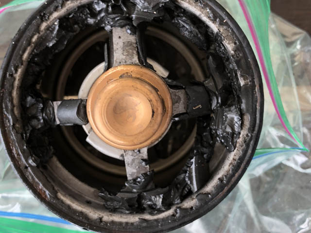

    On my starboard engine we removed the 3- 86 deg C thermostats. The rubber on each of the thermostats is destroyed. The rubber looks like it was eaten up. No problem on the thermostats on the port engine. Both engines have the Man approved coolant in them. When we were removing the heat exchanger on the starboard engine we found alot of rubber pieces but didn't know where it was coming from until we removed the thermostats. No one from Man has been able to explain why this has happened.

    You are correct they were replaced about 3.5 years ago. The 3 that were removed 3.5 yrs ago one looked similar. O rings in the HE end caps looked fine. As mentioned we did find rubber in the HE that we were unsure where it came from. We did think it might be RTV sealant but it wasn't. I did notice that the 3 thermostats did smell somewhat like diesel fuel and I've heard of something called cavitation created by lack of SPA in the coolant although I'm not familiar with it. Any thoughts?

    #1 send a coolant sample to the lab for level 1 and II testing.
    Other than combustion gases, it's not raw fuel you are smelling. Fuel pump has weep holes that would not mix coolant with fuel if it was leaking. Worse case; in the oil sump.
    You did not mention if the oil coolers were serviced. Oh, Back block gasket also? I'm still leaning to much sealant (of some kind) when they were re-sealed.
    Cavitation is an abused word. It is suppose to be high volume (sonic?) water wear around the lung walls. It does not make rubber.
    OTOH, you were doing the MAN HE per maintenance schedule or having troubles? If no troubles, slam it back together and go fishing.
    From my old school, grease makes a better low pressure gasket dressing than RTV or GOOP.
    It's the gasket or seal that should always be doing the work, not the glue or something is wrong.
    I do know that back block gasket to end plate before the flywheel adapter, There is something wrong there. On re-seals people use goop. Like the oil cooler, if grease was on the gaskets, they would not tear when distorted. IE torquing a hose to the cooler housing. IE the engine block torquing over from the clutch and flywheel adapter.

    Ralph we are performing general maintenance on the HE and intercoolers. The oil coolers don't get serviced. Oil cooler gaskets were replaced several years ago as that was a common problem with this particular engine.
    Will send antifreeze off for testing. This is definitely not RTV or any gasket sealant. It is the rubber particles that have come off of all three thermostats as you can see in the picture. Obviously something is causing the rubber on the thermostats starboard engine to deteriorate.

    MAN recommends changing the coolant and heat exchanger caps every 2 years. IMO it is crucial on them and I do it religiously on MAN boats that I maintain. I believe the MAN's are pretty hard on coolant and it can become acidic and cause issues. I follow the book on everything with MAN's except the cleaning of the heat exchangers every 2 years. I do those every 1000 hours or 5 years or the first sign of a loss of cooling capacity.
    I just find it odd that it is on one motor and not the other motor. Is it possible you got a bad gallon of coolant or something else got dumped in there.....It also could be possible something else is leaking into the cooling system, such as fuel, salt water, or exhaust gasses, I would have a lab test it.
