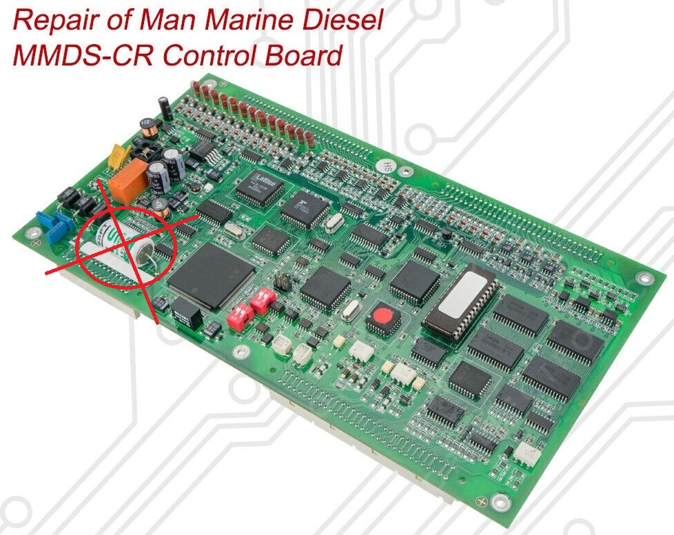

    Had a call from my dealer this am and he quoted me $850 plus shipping for each board to be repaired. Went down to the boat at lunch and went to turn on displays to check hours on Stbd engine (the one that had correct hours) and I couldn't believe my eyes. Stbd lost hours as well. They are both erased. I haven't turned power off to engines since this all started and had the boat out 2 weeks ago and that engine had 1972 hours. I was already planning to do both as I suspected it would need it at some point but found the timing ironic. Jumped on phone with dealer and he walked me through removal of the board in each black box that needs to be shipped to MAN in Florida. Much more involved that I thought. The MMDS board is what is removed and is located behind the MPC unit. Not an easy task. I took my time and listened to his instructions and even built up a platform to rest the MPX box while I removed the MMDS board on each side. Documented each step with pics.
    I asked the dealer again why one would want to make this repair and he confirmed to have accurate visual engine hours for operator and alarm history. Permanent hours still located on main board in black box and accessed by MAN laptop. The other reason is for logging any alarms that have gone off on the engines. Without the fix you will have no history of any engine alarms should one go off and dealer needs access to determine issue. I am OCD so I am getting it fixed and I like to know how many hours I am putting on boat. If you do nothing every time you start engines you get a new number so tracking your hours annually or for each trip would be a real hassle.

    Picked up my MMDS boards today at dealer and installed on boat this evening. Turn around was very quick and no issues. My hours were reset to 0. Main motherboard still has actual hours. Dealer didn't know why they didn't update hours he gave them during procedure. He can do it at anytime with 2 laptops as Capt J posted. Glad to be back together and updated.

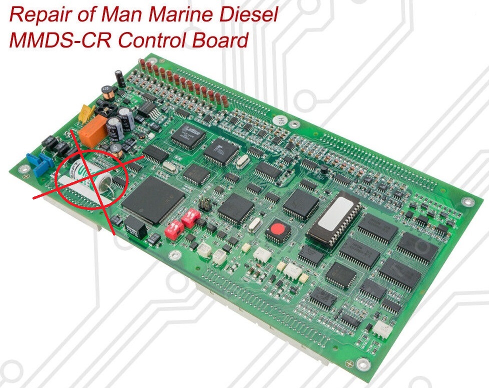

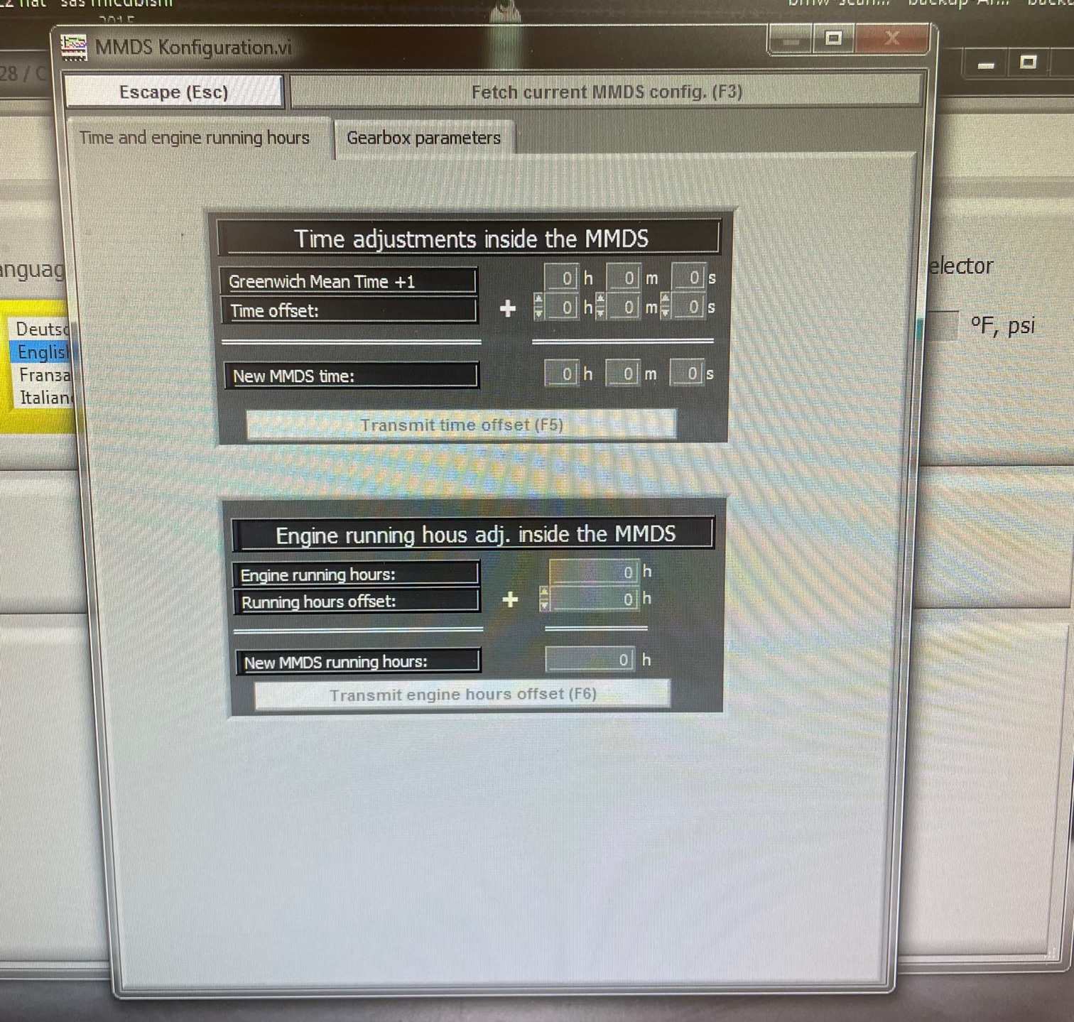

    Hi all.

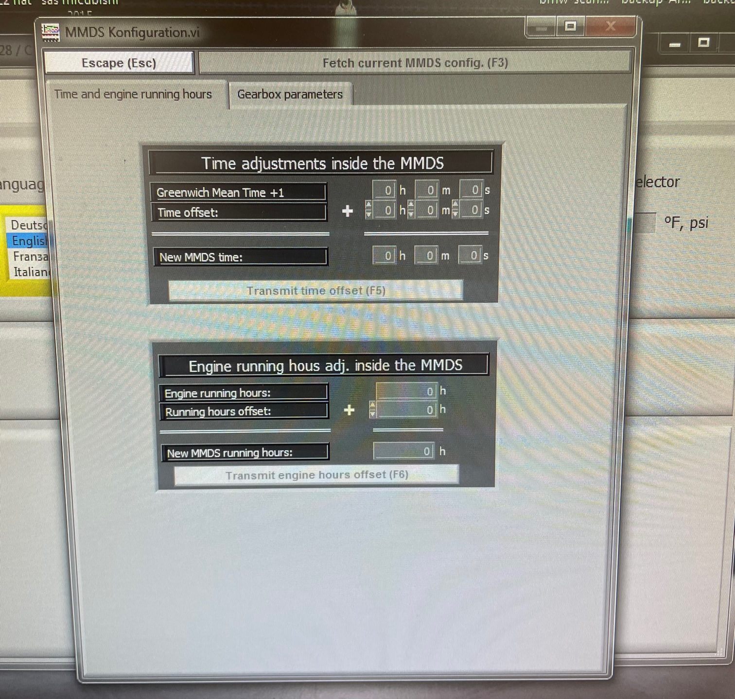

    I have a project with a detailed description of how to independently restore an MMDS-CR after a engine failure. The project includes a detailed description, cable diagram (very simple), software.
    Using this project, you can independently change the engine hour reading at any time.
    I worked for MAN as an engineer, now due to the fact that there is a war in my country I am not working (the sea has been closed).
    If you are interested in this project, write to on Skype ivan_nikol_
    Regards, Ivan

    Good afternoon.
    You're right, this is due to the failure of the batteries installed on the board. They need to be replaced - the system will immediately work stably. But the engine hours will be chaotic. In order to set the correct engine hours, my project is needed.

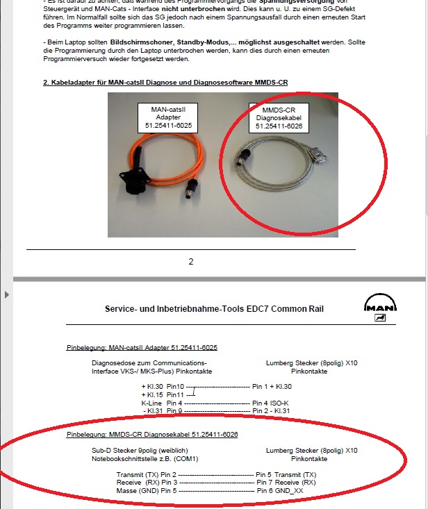

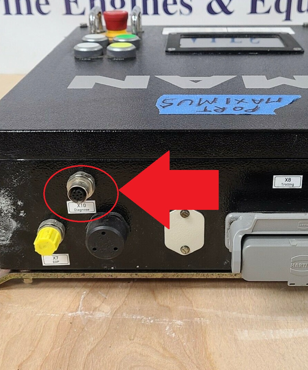

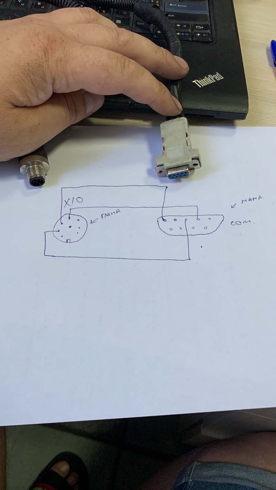

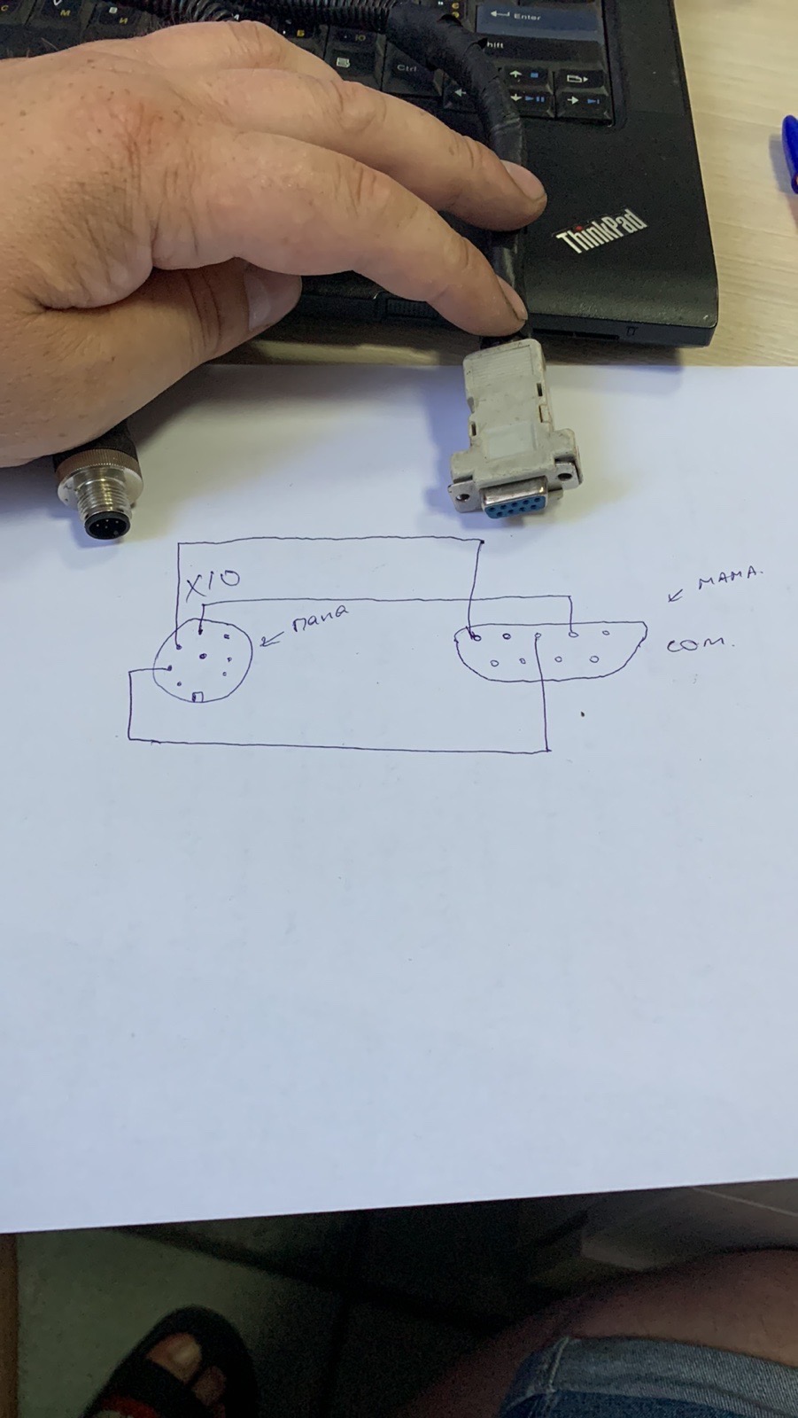

  14. Vanja
    Vanja New Member
    Dec 4, 2023
    5
    UA Odessa

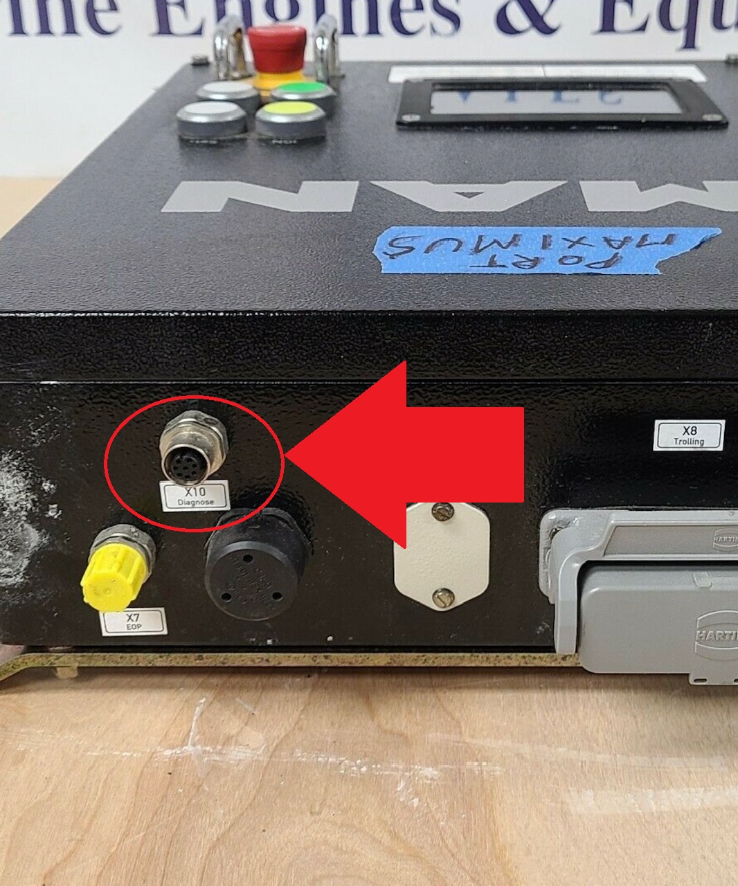

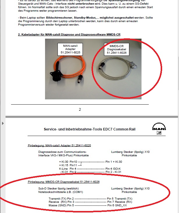

    In order to set the correct engine hours after replacing the battery, you can use my project. To do this, you need to assemble a cable from three wires and two connectors. I'm posting the diagram.
