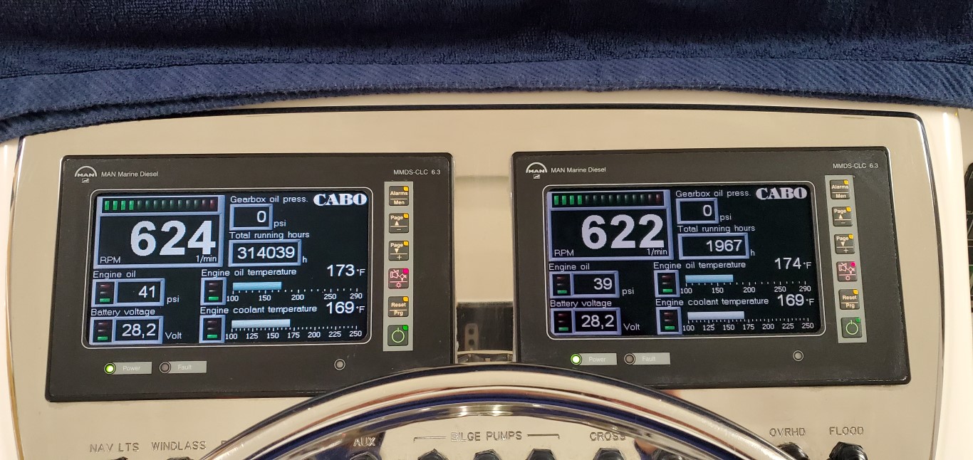

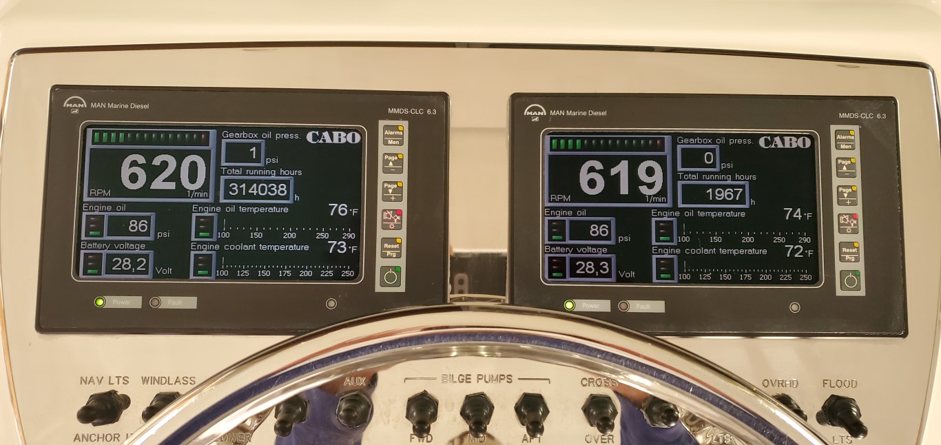

    During initial purchase 3 years ago I had read about the issues a few had with MAN engines and the engine display reading hours that made no sense. Since then I have never had an issue and assumed the lithium batteries in my engine black box had been replaced. Perhaps they had been but a recent health issue has cost me a very expensive lesson. I have searched past topics on this and what CapJ is saying is spot on. I have now spoken to my MAN dealer and have better understanding of actual issue. Sometimes it is hard to really learn about something until the matter is real. Hypothetical learning is tough in some instances I guess.
    Here is what happened to me and what I learned. Perhaps it can help others in the future. The Black Box on Common Rail MAN engines have multiple boards inside and one of them has a lithium battery that while the engines are shut off it stores information regarding engines alarm history and hours for the remote display. If power to the black box is turned off for a period of time the battery can run dead and that will cause you to have an erroneous reading on your remote engine display at the helm from that point forward. If you don't fix the issue then when you have an alarm there will be no record stored of it happening for dealer to see from laptop. The actual hours of the engine will be accurate in the black box and a dealer can easily see this by hooking up their laptop and running diagnostic. My dealer said that MAN has not communicated what is causing the system over time to draw down the battery when everything is turned off. Voltage to the black box keeps battery charged. At present time the only MAN authorized fix is to send the one board with the battery to Germany and they fix is for $9700. Are you F*ng kidding me. There is also a unauthorized repair that can be done aftermarket for $4500. What a joke. My dealer is talking to MAN about a resolution that would be authorized and only cost $800. time will tell.
    Here is how I got myself into this situation. I returned from a 575nm fishing trip that was absolutely epic and the boat performed perfectly. I had a few small engine room maintenance items I wanted to proactively do so figured why not jump on it now and not wait until winter. Just little things to keep MAN's dialed. During this small project I turned the T handles in the ER to off so no power was going to engines while I was in the middle of stuff. I thought that was the smart thing to do. Unexpectedly a few days later I go and have a heart attack. 100 % blocked artery at 40 yrs old. Super active and was playing full court hoops just hours prior. 5 stents later I was recovering. This was completely a hereditary thing. I go by the boat but per Cardiologists orders I am taking it easy. After a few weeks I take the time to finish my maintenance in the ER and button things up. I feel better and boat is back dialed so all good. I leave the boat feeling I am getting back on top of things and later that night my wife goes into labor and by lunch the following day delivers our baby boy. So 2 more weeks go by and while I stop by the boat several times I am not able to really get out and use it. Just check stuff and literally do a walk thru. After a total of 5 weeks I tell the wife I gotta go down to the boat and run all the systems. I never go this long without spending a day on the boat and running systems. I get down to boat and turn on breaker to engine ignition in the salon and remember that I had not turned the main engine T handles back on in ER. After doing so I go fire them both up and immediately see that Port motor engine hours now registers 314039 hours. WTF. I quickly remember my readings 3 years ago on this very site and my gut sinks as I realize having the power off for more than a few days has caused this. I warm them up and make sure all is well, which it is, other than this stupid lithium battery design from MAN. If MAN has a design that requires constant voltage to the system they should inform owners of that or at least acknowledge it. I am diligent about keeping the boat and engines dialed and am completely OCD when it comes to the Cabo. This issues chaps me more and more as the days go by. My dealer said this was a continued topic among dealers at FLIBS and I am not the only owner currently dealing with his issue. We will see what resolution they come up with but I am not forking over 10k for a F*ing battery the size of a penny.

    Not necessary to do that. Just keep power to the black box for each engine and start the engine and run it every x months. Depends how strong that lithium battery is inside blackbox. Stbd engine is fine. Just don't turn off battery power to blackbox for longer than a week is probably safe rule of thumb. I did 3 weeks when boat was on the ship from FL to Washington state with no issues but maybe battery was stronger at that time. Not sure if starting engine every so often is even a factor. Nobody really knows as MAN won't acknowledge the issue or not sure if they know what in the blackbox is draining their lithium battery.

    There is a place in Pompano Beach,FL that fixes the boards (MAX Marine I think is there name.) That being said, you still have to have the MAN dealer come out and verify the hours on the other internal board and then program the hours on the new board. It's a battery issue and not just the fact the boxes didn't have power for 5 weeks......the other one will screw up within 6 months...…… On the boat it happened to me on, it was 2 weeks apart.
    This is going back about 5 years, but on the 1100 CR boat I had them done on. I had the dealer here come out, and between diagnoses, pulling both boards, having them fixed, re-installing and hooking up the laptop and programming it was $4500 total.

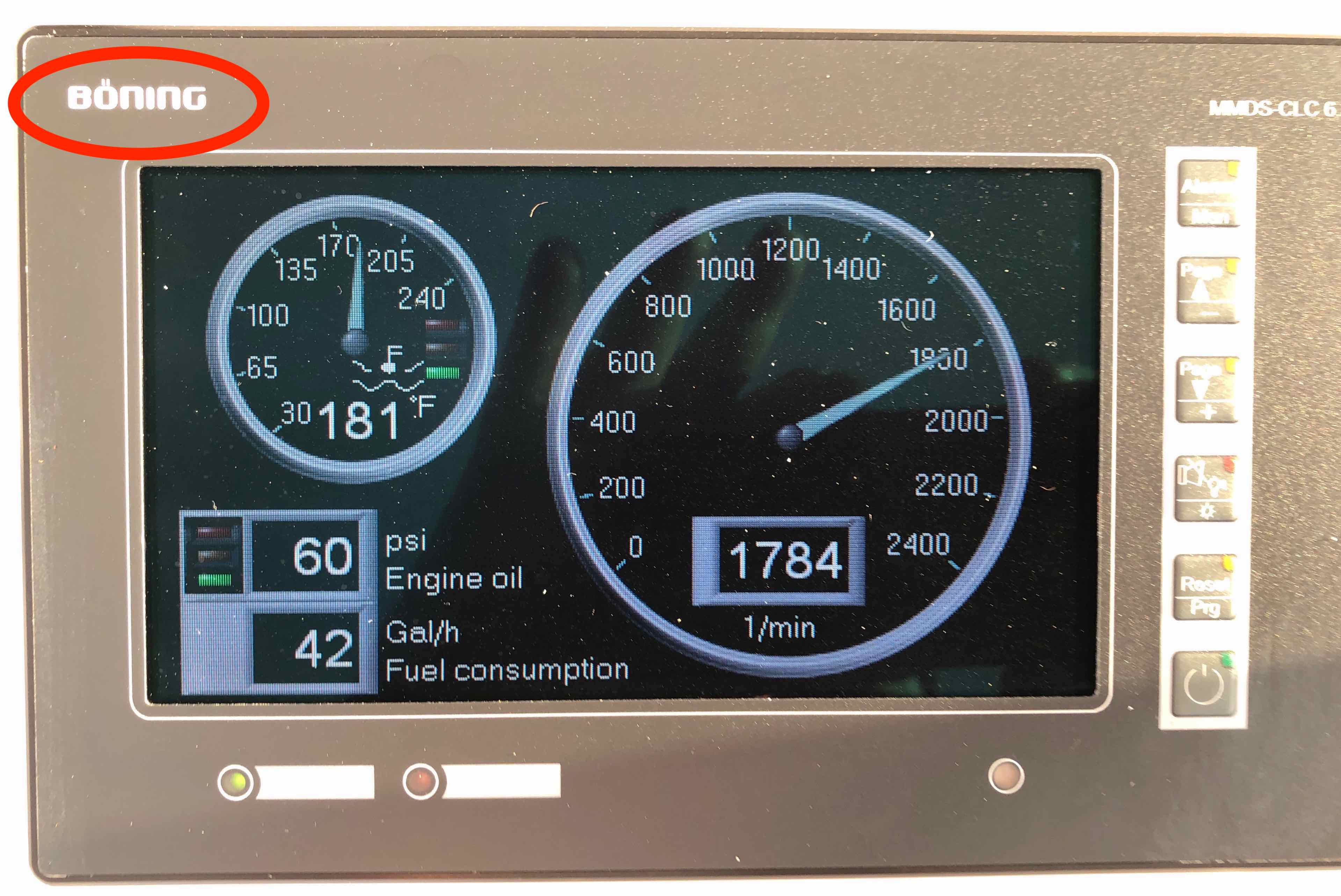

    That would be good news, because the whole engine monitoring system was actually designed and built by Böning.
    In fact, the only difference between the display you posted and those in the OP pics is that the latter have the MAN logo on the bezel, but only because Böning shipped them to MAN, as their OEM supplier.
    So, if Böning will find a workaround, it's reasonable to hope that it will be applied also to all MAN-labelled displays.

    The new monitoring boards supposedly don't fail. They record the information to the EPROM instead of the RAM or something to that effect. The board I had replaced were done in 2013 and are still working fine. YES, having the black boxes having power does help with not having the problems. My initial one failed after the boat was sitting with the battery switches off for a couple of weeks. Ignitions can be off. Boat had shorepower and battery charger on during that time period. Rexroth manufacturers the engine controls for MAN and Boening did all of the electronics side of things. The other inherent issue they had which has been remedied from what I can tell is they had senders failing left and right in the mid 2000's up until around 2013 (coolant pressure, air inlet pressure, expansion tank pressure, sensors of that nature
    Hours are stored in another part of the system, but you need the MAN engine computer software on a laptop to access them.

    Okay gents, bringing this one back. Powered up from the winter today- Both engines started up with no problems. Starboard engine has the run away hours problem now. Anyone come up with a reasonable priced fix in the last few months? I am nervous the Port engine will fail soon and I'll lose track of the hours. ugh!
