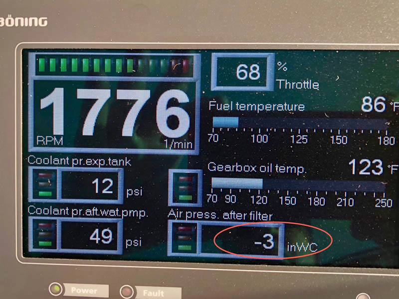

  4. BoulderGT3
    BoulderGT3 Senior Member
    Jun 19, 2014
    168
    Ftl
    It measures vacuum downstream of the air filter. A greater negative # equals a dirty air filter. IIRC it alarms at -1.5bar. Here's a pic of mine with freshly cleaned airseps.
