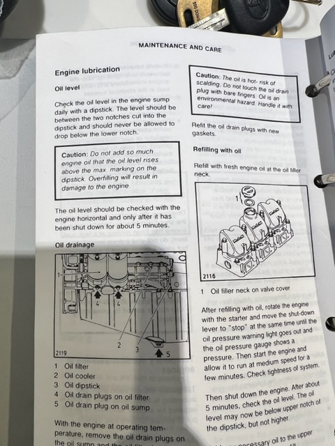

    I am familiar with that manual, because your D2840 LE401 engines belong to the same family of my (and Butch's) D2848 LE403, and the operation manual is the same.
    Now, you are correct in saying that it suggests to check not long after shutdown (20 mins actually, not 10 - but that doesn't make a relevant difference).
    I am attaching an abstract to the relevant page, together with the covers. Is this the same document you are referring to?

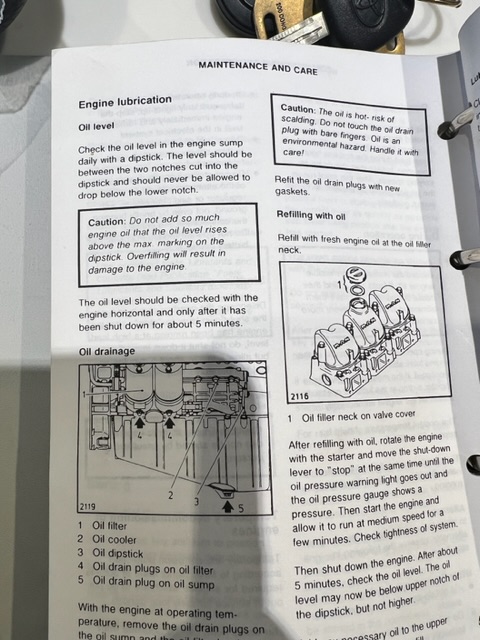

    Ok finally go to the boat. The manual says to check the oil “only after it has been shut down for about 5 minutes”, I only have the physical manual that came with the boat.

    "Below the upper notch..."
    What do you read in the morning cold without running them first?
    I'm sure consistency would be the best practice. But who wants to go check hot engine dips?
