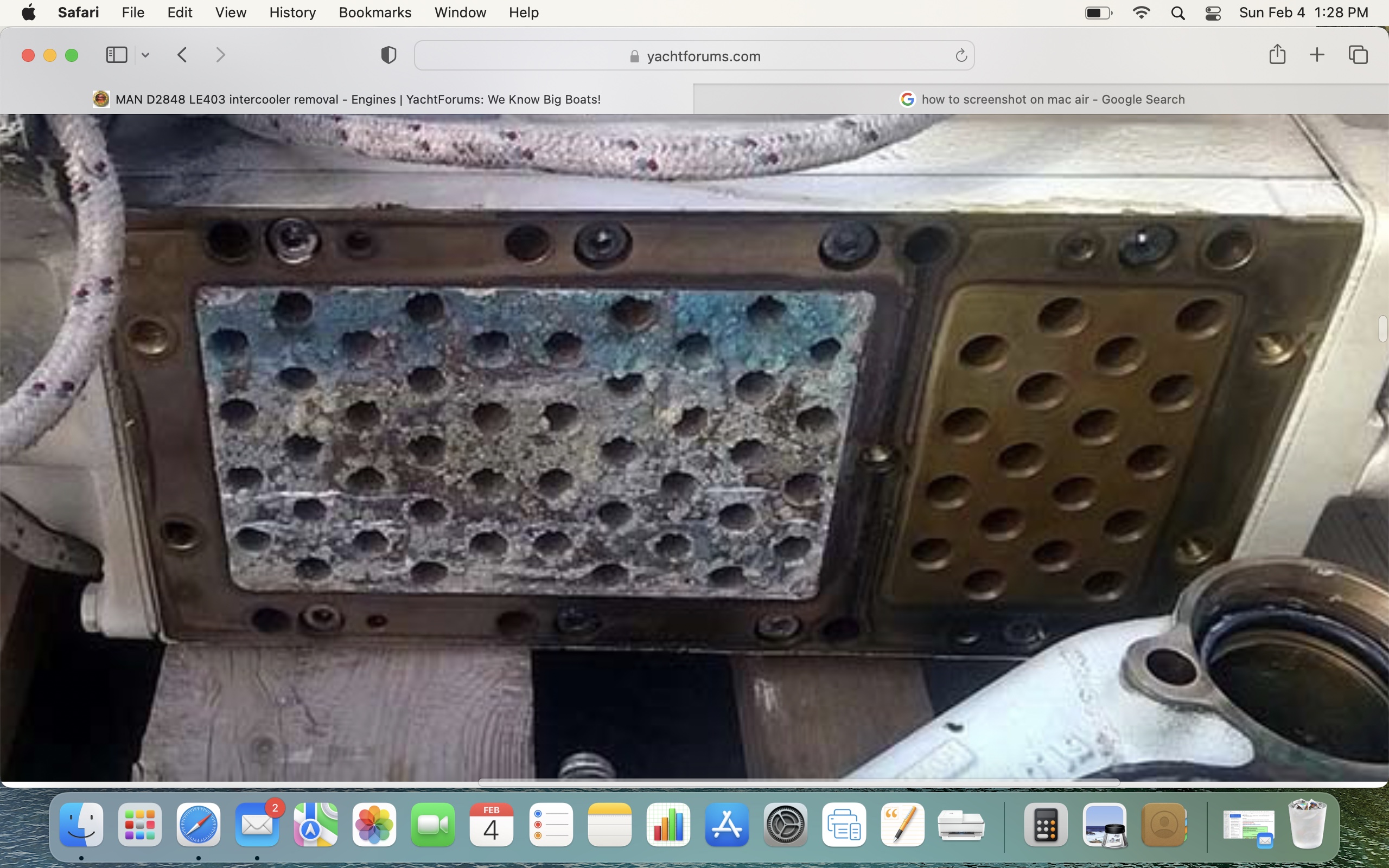

    Older thread but have a questions regarding the CAC's, do the raw water and coolant squares push out of the housing similar to the way the heat exchanger bundles do ? What is the best method to clean them, and service the unit per say

    No I don’t believe you can push the stacks out and I certainly never have. I just cleaned mine in a bath of descaler before on other engines. Mine this time we’re pretty clean so I left them for this year. Hope this helps

    The short answer is no, as kev cribb already confirmed.
    What you see in my photo that you quoted is the water side of the CAC, and its only peculiarity is that in these MANs it's split in two sections: raw water on the left and engine coolant on the right, as you look at them in the photo.
    Normally, only the former gets dirty over time, and once the CAC is stripped from the engine and opened as above, it's easy to clean it with any appropriate detergent available on your side of the Pond.
    When I stripped those CACs in my boat, which back then I had just bought and I wasn't sure about if/when/how they were cleaned previously, I actually opened also the air side. In the second photo of my post #14, you can see the whole CAC from above, with the two air ducts on both sides removed.
    I couldn't find in my files a better photo of the inner part of the air side, but the following gives you an idea of how it looks like.
    In my boat, it was pretty clean and all it needed was some compressed air and a cleaning of the surfaces where the air ducts are attached, before reinstalling them.
