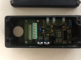

    Not sure if in the meantime you sorted the problem, but today it popped to my mind that I told you I was going to cross-check the behaviour on my boat with the very same engines, so here goes.
    On my dashboard, when I turn an engine key to the contact position (i.e. without actually starting the engine), three warning lights go on: alternator, oil pressure and coolant level.
    The first two stay on till the engine is started, and go off as soon as the alternator kicks in and the oil pressure builds up.
    The coolant level instead stays on just for a couple of seconds, and then it goes off regardless of whether the engine is started or not.
    Besides, in order to make a full comparison with your situation, I also disconnected the coolant level sensor to see what happens.
    And on the dashboard, with the plug disconnected, the coolant level warning light doesn't turn on at all.
    I know this doesn't seem to make a lot of sense, but that's the way it is, and it happens on both engines, so I would think it works like that by design.
    Last but not least, I also asked my wife to turn the key for me, while I checked what happens on the engine black box.
    And the result is in the video below.
    The first half of the video show in real time the "normal" behaviour of the warning lights on the black box.
    When the two upper lights turn green, the coolant level light on the dashboard goes off.
    The second half shows what happens with the coolant level sensor disconnected, when as I said the dashboard light doesn't turn on at all.
    I hope this helps your troubleshooting, if not already sorted.

    Not a problem to open one box and take a photo, but I'm a bit skeptic that you will be able to compare the wiring accurately.
    In fact, I already attached to my post #9 a photo of the box interior which I took some time ago.
    Below is the very same photo, just re-attached to this post for reading convenience.
    But if that's not what you meant, and/or you are interested in some specific details, just ask.
    [​IMG]
    PS: I only just noticed that this old photo was flipped vertically. I guess I did that just for easier reading of the Bosch label.
    I don't think it really matters, but just for clarity, the actual box orientation is as shown in the previous video - i.e. reversed, compared to the photo.
    PPS: I also have the original, much higher resolution photo.
    If you think it could be useful for you, just pm me your email.

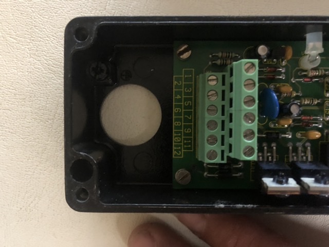

    Hi
    It was a photo of the inside of the smaller electronic box if you could.
    I have 6 wires in various colours just wondered if they are the same number and order of plug ins as mine. 1 to 6 or 7 to 12 and what order. You are more than a star and really helpful thank you.

    Picture of what I mean. Hopefully your colours match mine if everything is the same. 5830C259-67F1-441B-B142-C5EA597A17E5.jpeg

    Pic 2
    I have tried to upload another picture which it won’t except. Basically it’s the two green blocks numbered 1 to 12 and which coloured wire goes into which.

    It appears that also the smaller box in your pics is the same as mine.
    Ref. the wiring, check out the pics below.
    Obviously I didn't detach the small box and the wires, as you seem to have done. I just opened the cover and took some pics.
    The first shows a label which I found inside the cover, while the others show the whole box from different angles, and the detail of the wires.
    It wasn't easy to take a good photo of the latter, particularly of the green block on the back, but I can confirm you that there are just two wires attached to it, both white, and connected to positions 4 and 10.
    Lastly, don't ask me why the contacts in the label scheme don't match the actual wiring.

  17. kev cribb
    kev cribb New Member
    Nov 21, 2016
    45
    Gibraltar
    Awesome
    That’s you not the pictures
    Thank you so so much
    Your pictures tally with my wire colours and the order.
    I really like the nice rubber grommet seal that the wires go through and stop water getting in arrgggghhh which mine didn’t have. Hence my problem. Going to get one and then find the time to fit it and see. I will update once it’s all done so others have the info for the future.
    You really have been amazing with your help oh and so has the wife when she helped the other day.
