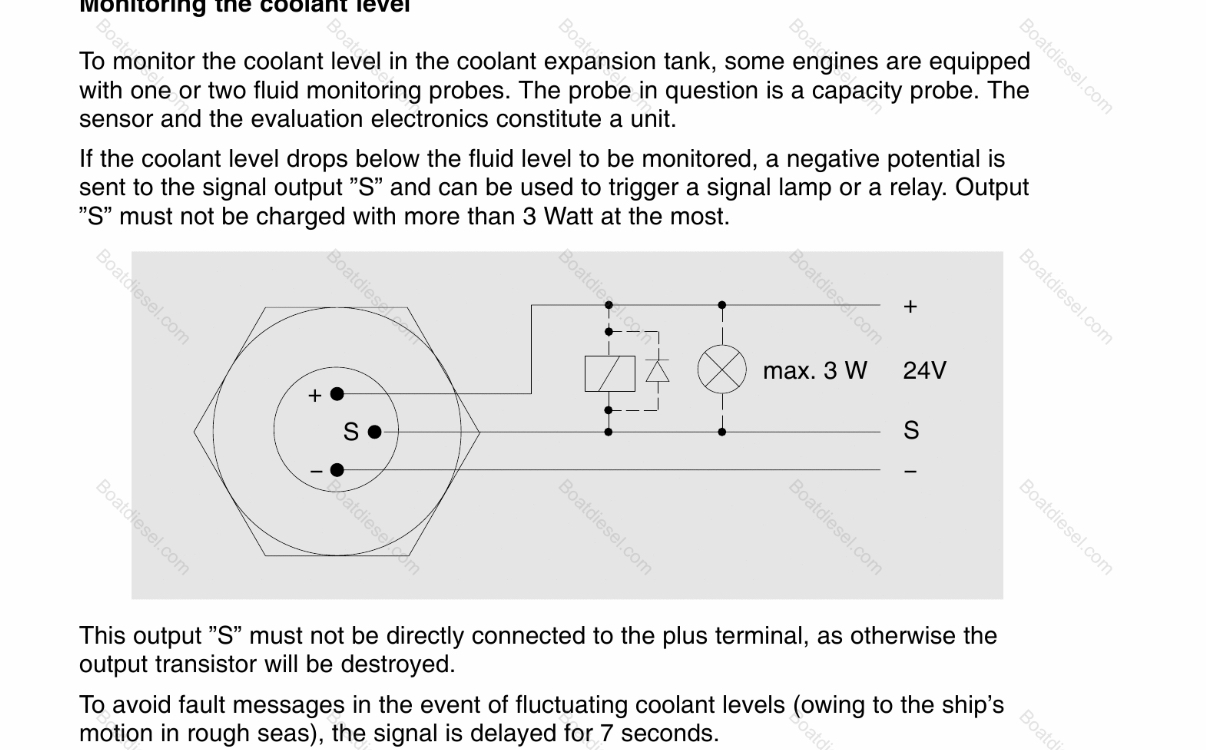

    Maybe this will help. Diagram from the manual with a little explanation on how it works.

    I'm still thinking you have a short up the line. Have your voltage meter handy - whether something "burned" out, or other wised failed, you've got juice going to that alarm. Track it back to the source?
    Can someone with more knowledge than I (everyone?) confirm how the sensor works the circuit. Do it close the circuit or open the circuit when its in a "non-alarm " state, and there is sufficient coolant in the expansion tank to cover it? That schematic and the OPs comments that the wires are disconnected from both sensors seem at odds?

    Can you get to the lamp and buzzer or relay with a multi meter ?
    Can you get to the sender with a multi meter.
    How hard is it to remove the signal wires from the sender ?
    You should read 24VDC across (+) & (-)
    If (S) is disconnected from the sensor, you should read zero across (+) and (S)
    Assuming (S) is not common to any other component.
    You say the alarm stays on even if the sensor is disconnected.
    If sensor is disconnected, & you read 24 VDC across (+) and (-) then the cable has failed.
    I don't know the distance but you can get three conductor signal cable and connect it in place of your existing cables temporarily to see if the problem goes away.
    This signal cable is pretty cheap - you could even use regular single strand wire from Home Cheapo just for a test but be sure you mark them on both ends or get different colors as you don't want to goof up the polarity.
    If the problem persists then you know it's not the cable
    The symbol with the diode may be a relay.
    does the manual have symbol definitions ?
    Possibly the relay might operate the buzzer and is stuck closed.
    Swap relays with the other engine.
    If the signal is as simple as that drawing then it seems easy to trouble shoot.
