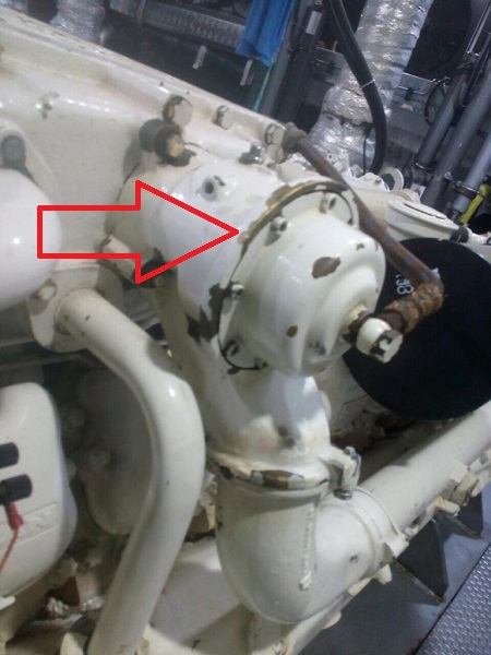

    Gentlemen,
    We have a 2009 MAN diesel engine, model no. D2842LE410 with the serial no. 70122258022224 which is suffering from a leaking sea water pressure regulator, part no. 50.06401.6000. I have attached a supporting image.
    I was wondering if a repair kit exists for the pressure regulator mentioned above or does the complete unit need to be replaced once it starts leaking.
    The above engine operates in Egypt, in the Red Sea which is a very warm environment with very warm sea water. From your view, do you believe it is possible to completely remove the sea water pressure regulator and fit an elbow instead which is also a setup existing in many other MAN diesel engines. If my suggestion is possible, is there an original part available from MAN in order to carry out the suggested modification to the engine?
    Thanks....

    Dear TK,
    Im wondering did you find the answer. Its old subject but I have the same engine. Thanks in advance...
  7. T.K.
    T.K. Senior Member
    Jan 31, 2007
    1,011
    Cairo - Egypt
    Good morning Oz,
    Yes, I finally contacted MAN Europe and an original parts kit did exist which can be fitted instead of the sea water pressure regulator and it converts the system to a standard and permanently open system without any restrictions in order to ensure full flow at all times and more efficient cooling in warm climates. I can send you the part numbers if you need to order it. It is extremely useful. We have fitted it and the engines now run much better in summer. Best regards, Tarek

    Hello, so I have a MAN D2842LE409 That I'm repairing. The pressure regulator diaphragm is punctured and I was looking for the repair kit as well. You said that they do have one? And also I see that leaving it open is also best for hot climates like mean which is in key largo FL. So wondering if you can get me the info on the repair kits or contacts. And what is best recommended for these motors.
  10. mapism
    mapism Senior Member
    Aug 9, 2008
    2,232
    Sardinia
    You don't need any repair kit.
    It's sufficient to strip the pipe and replace its special connecting screw with a plain vanilla screw.
    The only trick is that this screw must be long exactly as much as necessary to keep the diaphragm stuck open.
    Can't remember this exact length by heart, but any half decent MAN mechanic should be able to advise.
    Don't forget to replace also the connecting screw at the other end of the pipe, connected to the pressurized air intake.
    But this is even easier, because you only need a very short screw, just to plug the hole.
    That's all you need.

    I meant to say previously, but I forgot.
    Beware, the rationale behind that valve is NOT reducing startup smoke, as mentioned in the old post preceding yours.
    The smoke reduction upon cold start that the valve can grant is anywhere from almost and completely unnoticeable.
    What the valve is really designed for is avoid cooling charge air when the turbo is not spooling, i.e. at very low RPM.
    In fact, in those conditions, and with a cold sea water temperature, the air feeded to the engines could get excessively cold.
    Bottom line, if you are using your boat a lot at displacement speed and in cold waters, it makes sense to have a fully functioning valve.
    Other than that, it's useless and you can lock it open as I previously explained.
