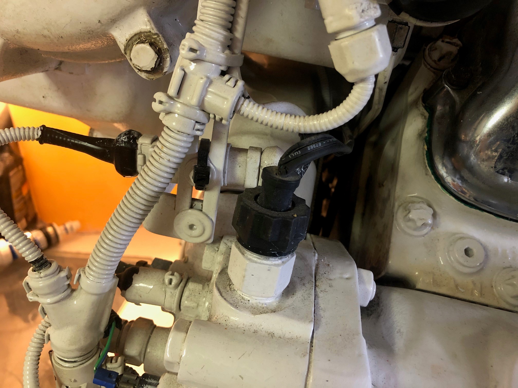

    And the inboard side, I am not sure how to insert them so you can see them without clicking on them...

    Yep, HotStart heater and thermostat. Same on my Detroits.

    Completely different set up then mine....

    The second photo is of the thermostat. Mine is in a different spot. If you unscrew the cap you should have a double pin plug inside. Try cleaning the pins and receptacles? Make sure the system isn't energized when you do that. Did you test continuity on the heating element and the thermostat? Does the system throw the panel breaker when you try to engage the heater? Are the engine breakers in the ER in the "on" position? Sometimes during winterizing they can be shut off inadvertently by moving around the engine space.
