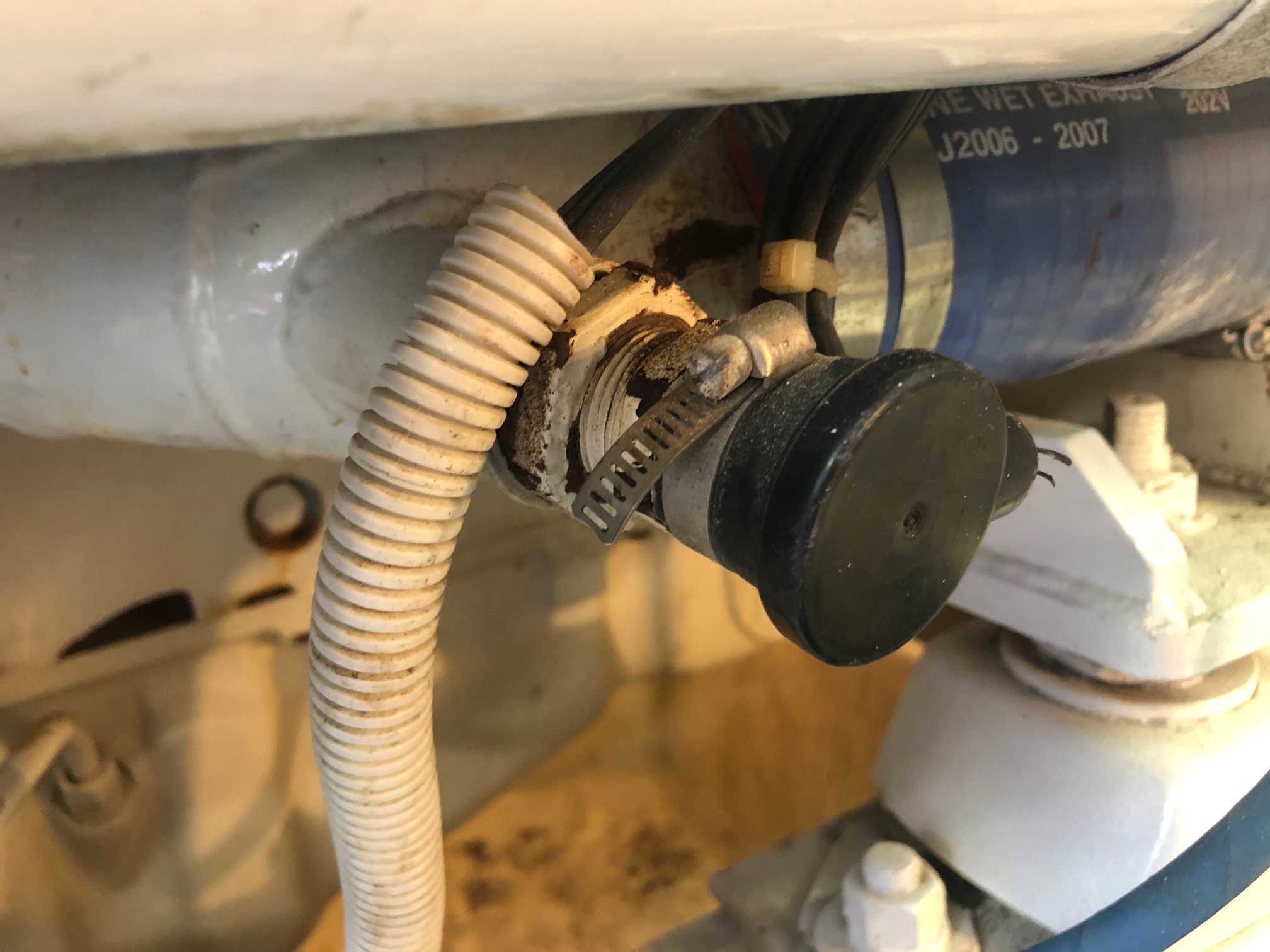

    So while doing some winter work and wrapping up the A1 service, it looks like my stbd block heater is toast as it keeps popping the breaker. I went through my MAN repair manuals and there is nothing listed for the engine block heater. It looks like there is a plug that ties into the coolant system right before the oil cooler and then another at the front the exhaust manifold. Has anyone replaced their block heater and if so, do you know the part number and where to source it from? It seems like a very simple system but I haven't dug too deep into yet as I have had a 1000 other items I am trying to wrap up (the boat has become my social distancing home office for now). It looks like I just need to drain the coolant system, and swap in a new unit, but are there any other things I am missing in troubleshooting the problem?
    Thank you in advance for any help or advice!

    If it'd the normal heater element (HotStart), You screw it out of a cold engine and screw in the new element. Minimal coolant loss.
    Lets find the operating voltage (115 or 230Vac) and a model number on the bake-lite side of the heater.

    Try Bayside diesel in Mystic. Over the years I have replaced 2 or 3 units. It's a submersion unit as you have identified with the U shaped heating coil located on the left hand lower side of the block facing forward. The screw in at the top front of the freshwater supply at the heat exchanger is the thermostat. These are german engines and I think its all metric
    Simple change. Turn off the 110 power though. I believe they have two ranges 110 degrees and 90 degrees determined by wattage? Ask Bayside.

    At least the warm weather is due.... Have you opened the thermostat to be sure the contacts are clean - worth a try I guess. Also put a continuity meter on the heating coil to determine if its intact and not corrioded. I don't know what that does to help the situation....but it does give you info.

    So the thermostat is on the left side of the engine facing forward at the front where the coolant runs into the exhaust manifold I believe. Is the port by the oil cooler just a sensor?

    Send me a pic of the oil cooler? Our set ups may be different. I have the heating element in the side of the engine, by the oil sensor, and a thermostat near the heat exchanger on the front of the engine.

    Finally got down to take some pictures, Here is the outboard side
