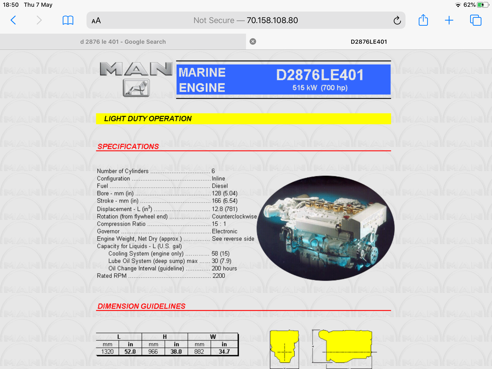

    They stroked the i 6 for the 700 Hp up from 610 Hp by increasing the stroke . 155 to 166 mm ,
    because it’s got further to travel for more or less same piston speed it’s WOT was reduced to as said 2200 .
    Think bicycle crank , it’s a bit longer and thus produces more torque .
    Realise shorter stroked 155 mm WOT @2350 rpm in the Vs .
    After it’s annual lift / service it reaches 2275 rpm so about right slightly over or in other words under propped to take into account seasonal fouling etc .

    That's not correct, F42. The stroke has always been 142 mm, for V engines.
    It's true that the D2866 had a 155mm stroke, which in your D2876 was increased to 166mm.
    But in both cases the red line was at 2200.
    On the other hand, in the common rail 730/800, the stroke remained 166mm as in the D2876, but they increased the rated rpm to the same 2300 of all V engines.
    Therefore, obviously different stroke alone can't be the reason for the different max rpm.
    But don't ask me which were the other evaluations of the chaps in Nuremberg, if any.
    To my simple mind, both keeping the same 2200 rpm when the stroke was increased from 155 to 166mm, and also increasing it to 2300 later, had more to see with the marketing thirst for power, which is what sells engines, more than anything else.

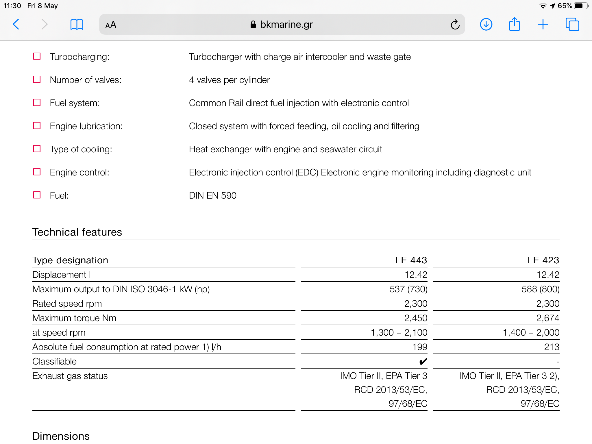

    This power arms race throws up some alarming numbers . 5457D6AE-5E6A-4A11-9B39-6724838AEAFD.png
    Compare the fuel burns around WOT ....crikey 199 213 L/h with the new versions @ 2300 rpm compared to 136 L/h with old version I have .
    So even though the marketing men at boat show stands can brag etc ., think of the stresses inside the cylinders achieving 800 Hp have to burn all that 213 L / h .........
    Or worse still 199 for an extra 30 Hp over my 700 s which @2200 burn 136 !!
    Moving back to real world usage as I said I set mine @ 80 % load ( because I can ) which burns @ 1780 rpm about 70/80 L/h per side , and according to the chart ^^^ takes out around 630 Hp ...approx .I get a happy 28/29 knots cruise .
    So with the newer modals i would not be happy having to run N of 2000 rpm all day long nudging into the 2150 to 2250 to see anywhere near that 800 Hp
    That fuel burn is crazy !
    May be when new + under warranty but fast fwd 15 years as a used proposition ?

    LOL, it's rather that Greek MAN dealer whose website shows those numbers which is a bit crazy, methinks... :)
    They must have made a cut and paste mistake or something, because neither the 199 l/h for 730hp nor the 213 for 800hp pass a basic sanity check.
    For your reference, I am attaching the official MAN leaflet, where at page 4 you can see that the right numbers are 145 and 158 l/h respectively, not 199 and 213.
