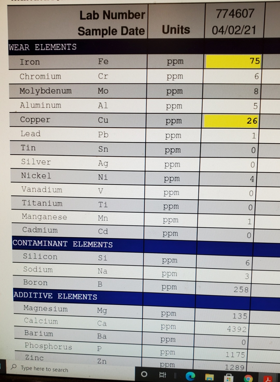

    Screenshot_20210405-224832_Gallery.jpg 1550 mans...4300 hours. Engine survey flagged iron and copper on one motor and iron on the other for more frequent sampling....is this anything to be concerned with? Screenshot_20210405-224832_Gallery.jpg

    Too low to worry about IMO. Indicative of a boat that's been sitting more than it's been running. However, if I saw over 150 ppm of iron or 60 ppm of copper, then I'd be worried. Sodium is extremely low, so motors haven't been run in rough conditions (sea) since the last oil change. You posted the same sample twice. What does the MAN dealer think of the samples?

    i was having trouble attaching the pic....port motor was lower on the numbers so i didn't post that.
    Last line on the report that was a separate document from the oil sample ,,,,run motor every week, problems happen when they sit. I guess that was in reference to the oil sample

    Not sure of the exact age, but since the 1550 was introduced a dozen of years ago or so, even if the engines would be among the earlier ones, at 4300 hours I would rather think the opposite.
    I agree that it's nothing to be concerned about, anyway.

    What I learned about oil samples is that their value is in comparing multiple samples over time. Sort of like blood pressure. High blood pressure could be because you just had a fight with your wife. If it's off the chart bad that's one thing, but generally your doctor is looking for if it's steadily rising. Same with oil samples.

    During break in, the first 2 or 3 oil changes, showing higher levels of some metals is normal. Also after laying up. That's why you want a series of samples. Is it about the same after this summer's running as it was after last summer's. If not you ask yourself if the difference was caused by running harder and longer or putting more strain on the motors through things like towing or just the motors getting older. If the numbers are getting higher with no use cause you've got something to check into. If the numbers are radically different you've definitely got something to check. But there's lots of causes for minor changes. It's just one diagnosis tool in the tool box and a good one. But one report generally tells you very little unless the numbers are real bad..
