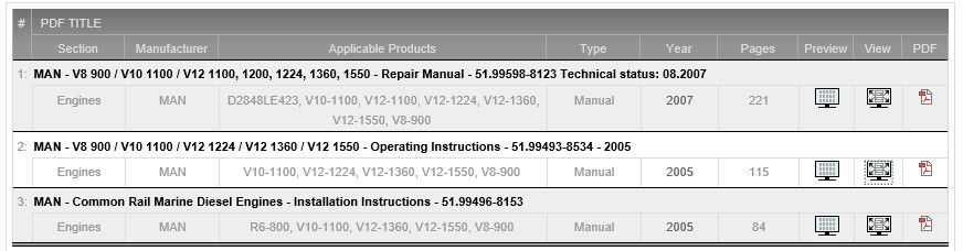

  8. P46-Curaçao
    P46-Curaçao Senior Member
    Mar 8, 2013
    734
  9. olderboater
    olderboater Senior Member
    Sep 2, 2013
    7,132
    I know....but you said you were guessing his were pre-common rails and I didn't see where he gave the age of his boat or engines, which I think would help him in seeking an answer. That was my question if perhaps I was missing something.
