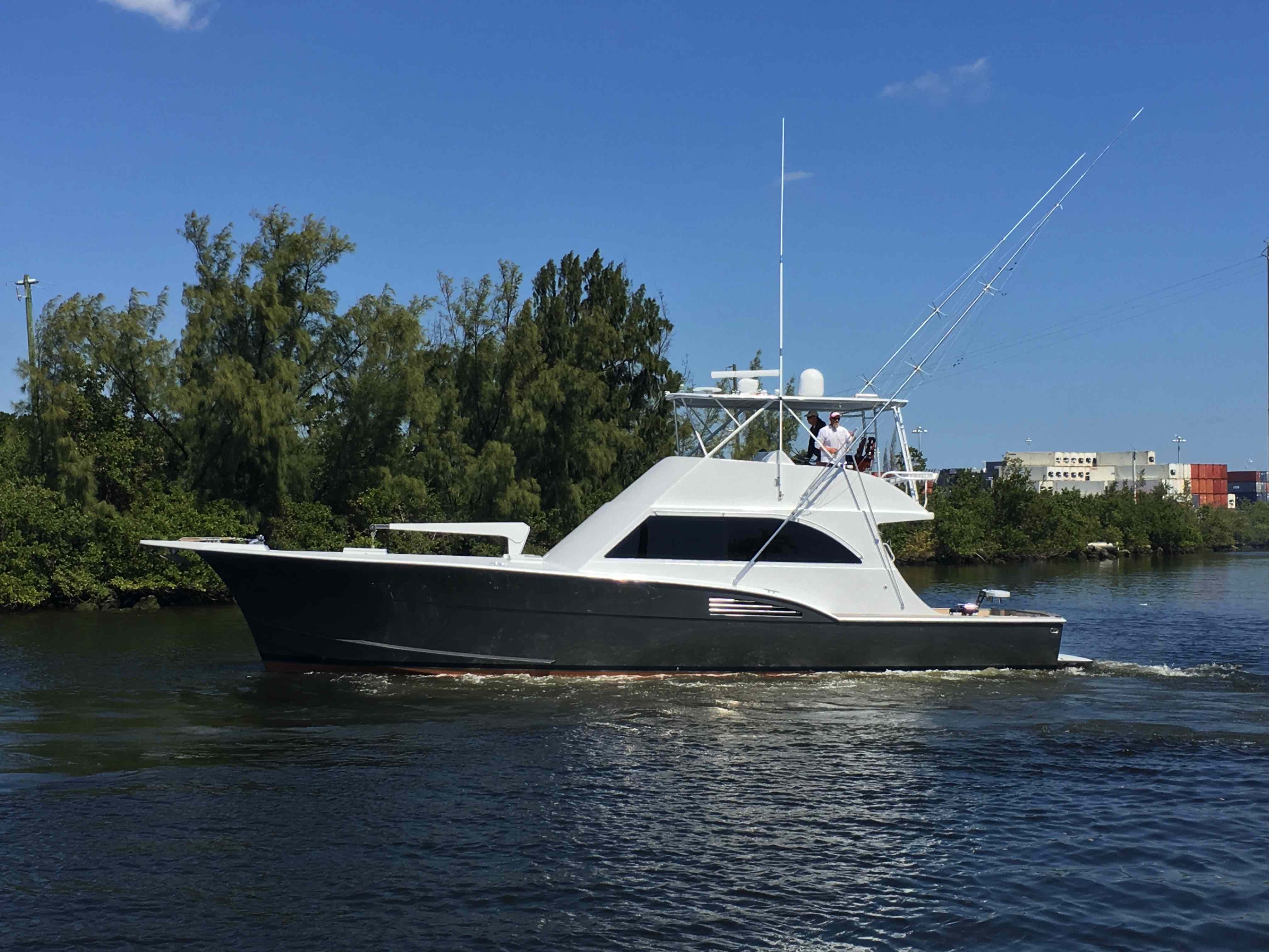

  14. rtrafford
    rtrafford Senior Member
    Jul 13, 2019
    1,979
    Vero Beach
    And just for fun, I'll give you a hand:
    • Lightened, well, much of that was easy by simply replacing the old Detroits and Allisons with modern Cats and Twins. Then out with much of the solid fiberglass (and wood interior walls) up top, and extensively implementing nidacore. I was able to lose an estimated ton between the cabin sole and the flybridge alone.
    • As for strength? Nidacore is plenty strong, as is the original Hatt hull, but I rebuilt the interior structure, replacing the 3/4" intermediate bulkheads with 1.5" resin penetrated marine plywood replacements (again, adding weight to the ver bottom of the vessel, as well as the entire floor support structure of the front area, replacing the floating 5/8" plywood truss system with 1.25" integrated/structural stringers.
    • Hatt had tabbed in many of the structural members. I fully glassed them while spreading the glass load out 12 to 18 inches in some areas.
    This was a very careful and methodical rebuild over a 2 year period. I've no plans to do this for anyone else, so I have no need to start a thread and display my work. I do know quite confidently that there is not a better boat on the water in its class. Yes, there are faster ones, more fuel efficient ones. The hull does have its trade offs, speed for softness. That's why Tom Slane makes a living doing what he does. Fishermen understand the quality of the boats.

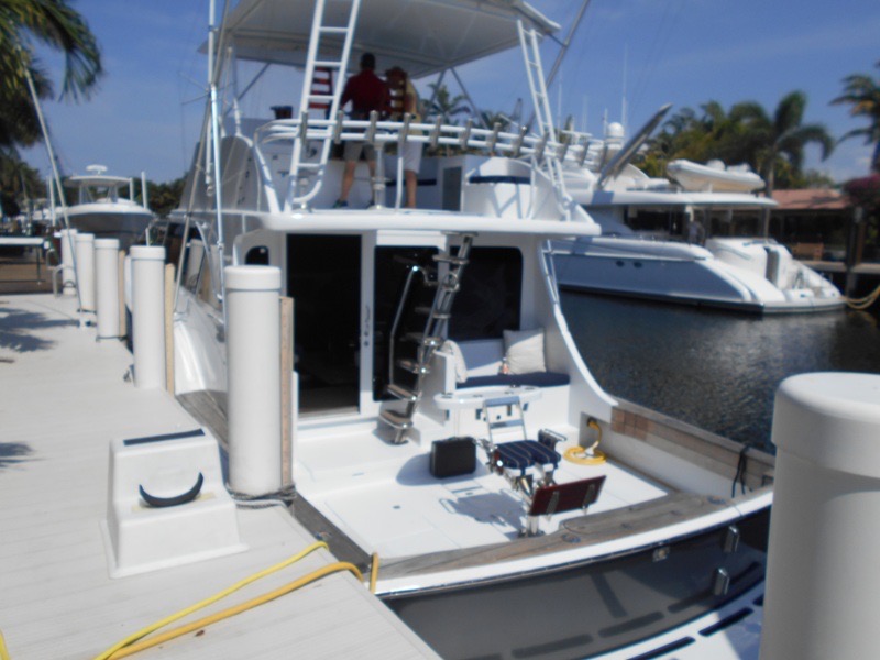

  15. Enyar
    Enyar New Member
    Apr 13, 2020
    7
    Clearwater FL
    Do you have a build thread for your 53?
  16. rtrafford
    Jul 13, 2019
    1,979
    Vero Beach
    I did post several things on Sam's forum with regards to the build. It took place from 2007 to 2010 with some very helpful input from Slane. Boat has since been sold and is roaming the Bahamas at last contact, back in early March.
