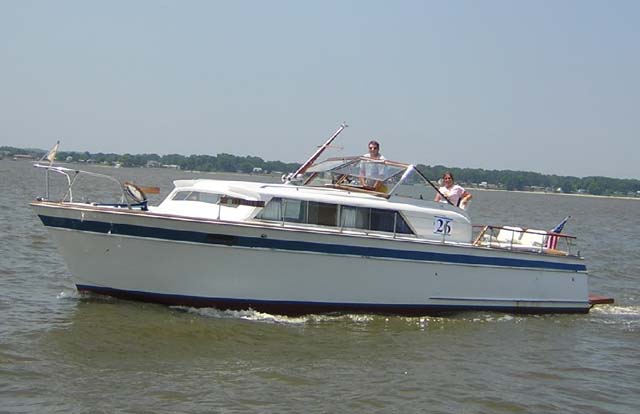

    Here is a pic from this past Sunday during the parade.

    She looks verry nice hope you got a nice summer crusin

    Yes, it is a head turner. Congrats and enjoy.
