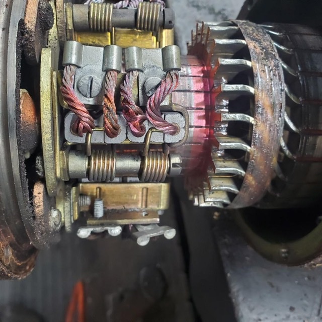

  8. cleanslate
    cleanslate Senior Member
    May 29, 2018
    1,661
    Cherry Hill, NJ
    59A79471-500A-49F2-8F73-623E6113B50B.jpeg Getting funky…old starter. Told you I was doing a lot of cranking…
  9. Capt Ralph
    14,582
    A lot of cranking and whining, yea, yea, yea. :p:p
    Ya think that missing brush screw on the pic bottom means anything?
    Where the other screw IS, the plate has been hot a few times.
    I've seen lots worse still cranking it out.
    Sometimes, ya really need to pat our ole starters for what it does, where it does it, the environment it does it in and how long it's been doing it.
    And not been touched, cleaned, oiled or even thought about in years.
    Amazing..

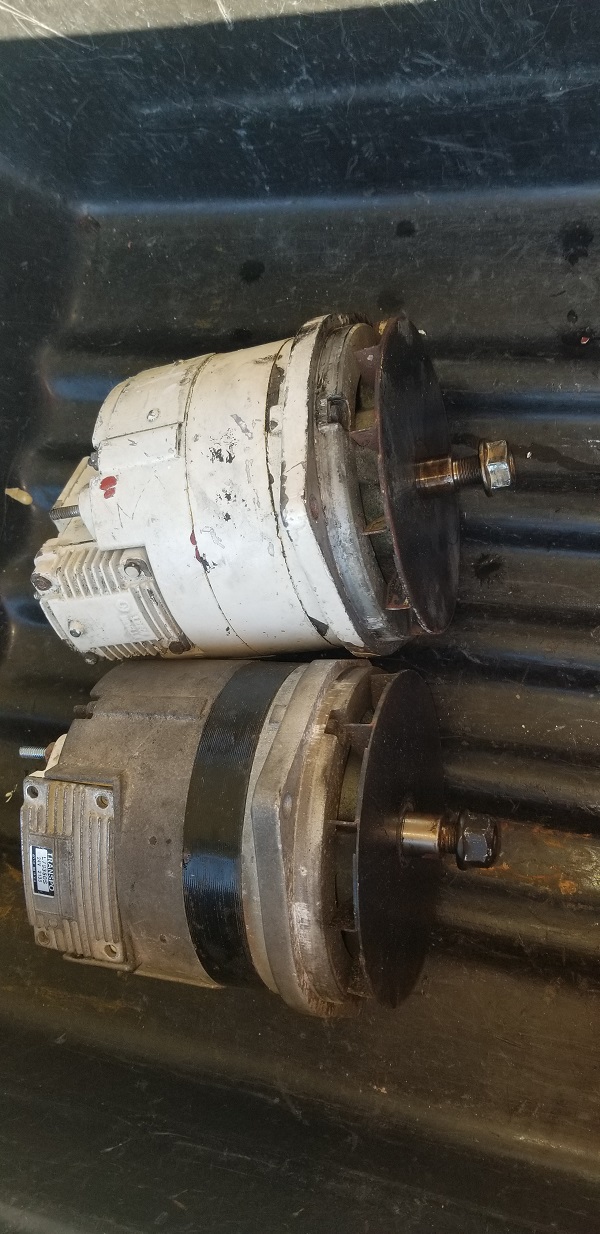

  10. Capt Ralph
    14,582
    Just pulled both of my partners Leece Neville direct drive alternators.
    Fried bits and pieces were falling out of them.
    I am supposed to provide rebuildable cores. Looking forward to this adventure...

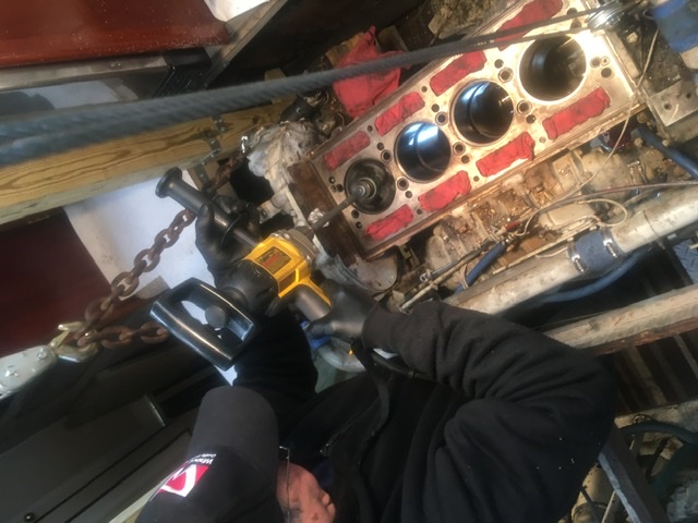

  13. cleanslate
    May 29, 2018
    1,661
    Cherry Hill, NJ
    CDC6A0F8-7E1F-45B7-AD82-5CF9B4362BA9.jpeg Just cleaning things up..
    light honing. Someone told me about this …? Oh yeah CR.

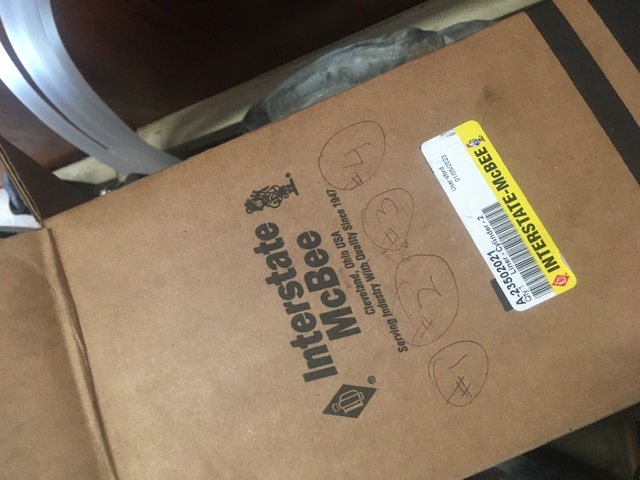

  14. cleanslate
    May 29, 2018
    1,661
    Cherry Hill, NJ
    EC62E414-C5F9-4D82-8180-2A38BD6972F5.jpeg This is the liner for 1-4 …
  15. Capt Ralph
    14,582
    Now your tech will measure the bore and order the rite class size liner.
    Getting the new liner to fit the case is very important. Expansion, heat transfer and long life depends on this fit.
  16. Capt Ralph
    14,582
    Your to fast, new liners in hand?
  17. Capt Ralph
    14,582
    So, as long as your full of surprises, The cam shaft lobes and height been measured yet?
