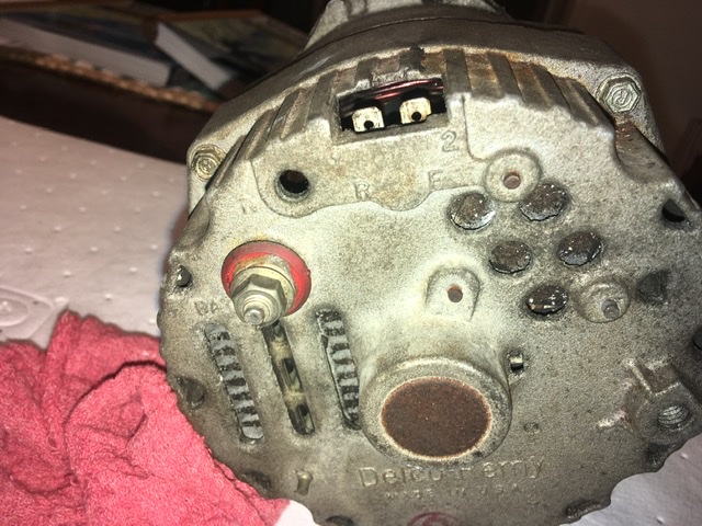

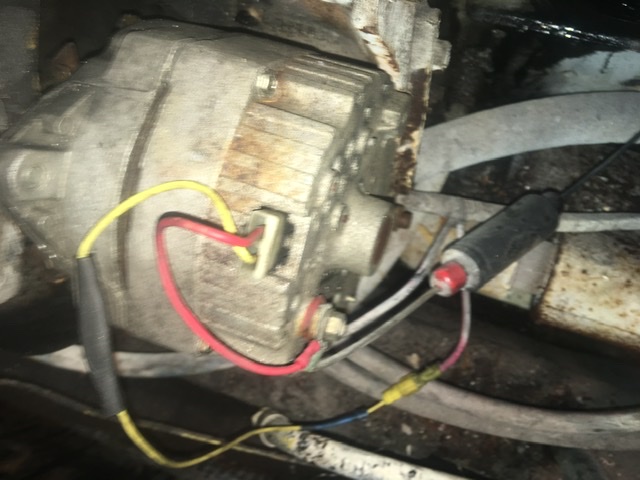

  10. cleanslate
    cleanslate Senior Member
    May 29, 2018
    1,661
    Cherry Hill, NJ
    82B49322-ACB5-4BB3-987F-419C4E8612AB.jpeg I need just a little help with the old original alternator;
    In the photo what is the black cigar tube looking thing that goes from the alternator to the engine block?
    Is that for the old Loran and Marine electronics interference gizmo?
    Should I keep it on or is it not needed anymore?
  11. Capt Ralph
    14,552
    Old Delco alternator. Usually self exciting.
    I have no idea (WTF) that yellow wire or that cigar thingie is.
    Pull that plug, look down into the two male spade terminals, if there is a jumper between them, cut that external sheet off.
  12. cleanslate
    May 29, 2018
    1,661
    Cherry Hill, NJ
    F091B08D-68EB-4FD6-AED0-DF32D5150834.jpeg Close up;

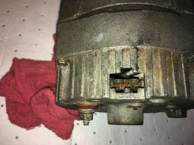

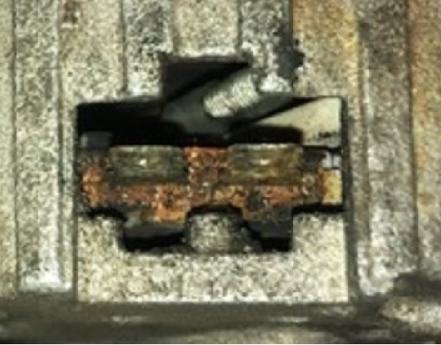

  13. cleanslate
    May 29, 2018
    1,661
    Cherry Hill, NJ
    And another ;
    “R” on left “F” on right
  14. Capt Ralph
    14,552
    The factory jumper looks like it has been removed.
    Make a jumper with two F spades connects and short wire and tie the pins together.
    Cut that other sheet out of there.

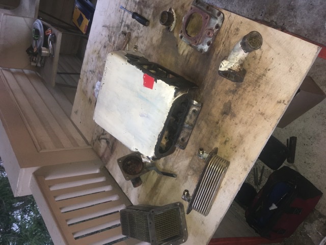

  18. cleanslate
    May 29, 2018
    1,661
    Cherry Hill, NJ
    Getting close to wrapping up the heat exchanger tank and all components within it…
    Everything is in good shape for 42 years old!!
    Transmission oil cooler was extremely dirty…. A5B928EE-C690-4F10-B6CF-A2EF42D42152.jpeg

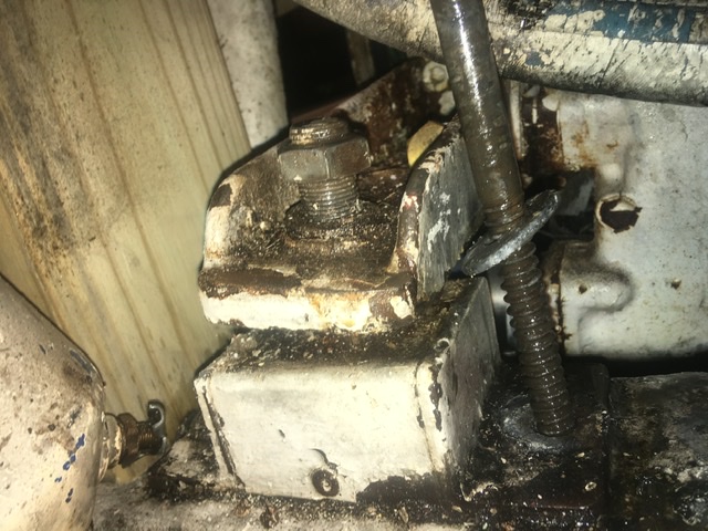

  19. cleanslate
    May 29, 2018
    1,661
    Cherry Hill, NJ
    CR! Was on the boat yesterday plugging away. My negative cable goes directly to the starter. Then another short cable goes to the block. All of it looks good and solid . But rather dirty and a little rusty on the out side. Starter looks spooky on the out side , rusty needs paint , but otherwise it always works fine. Given what some have said on here about current China made starters , I’ll keep my ugly good Delco starter on clean it up and paint it.
    All the cables / wires so no signs of wear and tear or electrical strains/surges.
    New problem; my motor mounts are shot. One is still rusted in place after two weeks of soaking in penetrating oil.
    Another one while removing the nut the studs started turning freely within the base of the isolator…
    Mine are Acemount 730 series www.acemount.com
    It’s one of the 731 units . Have to get exact measurements today.
