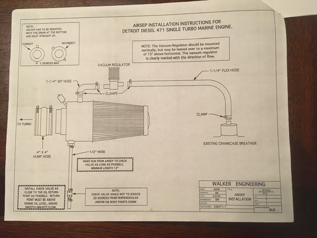

    Drawing;

    CR ! Thanks for sending this. Was going to clean the inside of mine......Now I won't. Fine with me.

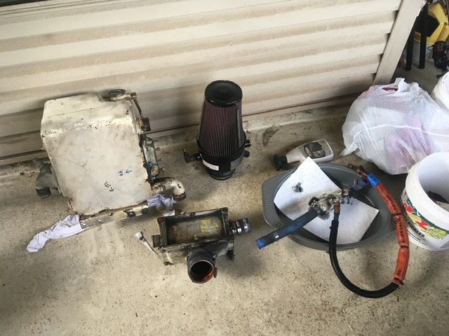

    More stuff removed from the engine. I’m getting there. Only stepped on my shaft zincs twice while lifting the cast iron heat exchanger tank off the engine and out into the truck. Heavy…
    H/E tank , intercooler, turbo oil cooler. AC523160-1BA5-47B4-A10B-806534DBDF63.jpeg

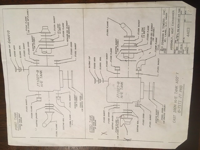

    My heat exchanger tank drawing Johnson and towers used both on 471s and 671s. FYI for those who may need it. 7B683DA2-CBBB-469A-B90F-D3A39753B2C1.jpeg

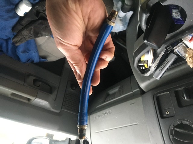

    Let’s celebrate! I bought my first part towards the engine overhaul!
    A $10 hose for the cooling water heat exchanger tank to water manifold connection. I’m practically done the project! 1B7227CB-A36F-43FA-8BC6-FBE49062C3E6.jpeg

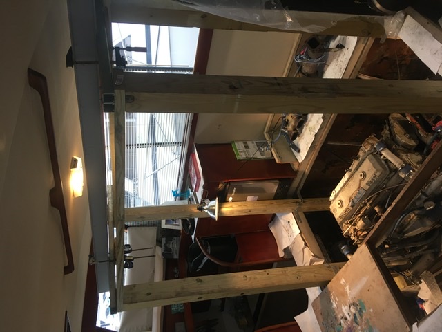

  20. Capt Ralph
    14,574
    Get some angle or cross braces on that.
