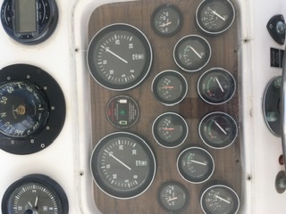

    Current numbers early this summer @2000 RPMs. During a run. B3480798-9469-496D-B898-1025248CE907.jpeg
    Tach , water, oil, clutch gages are accurate.
    Volt and fuel gages a work in progress.
