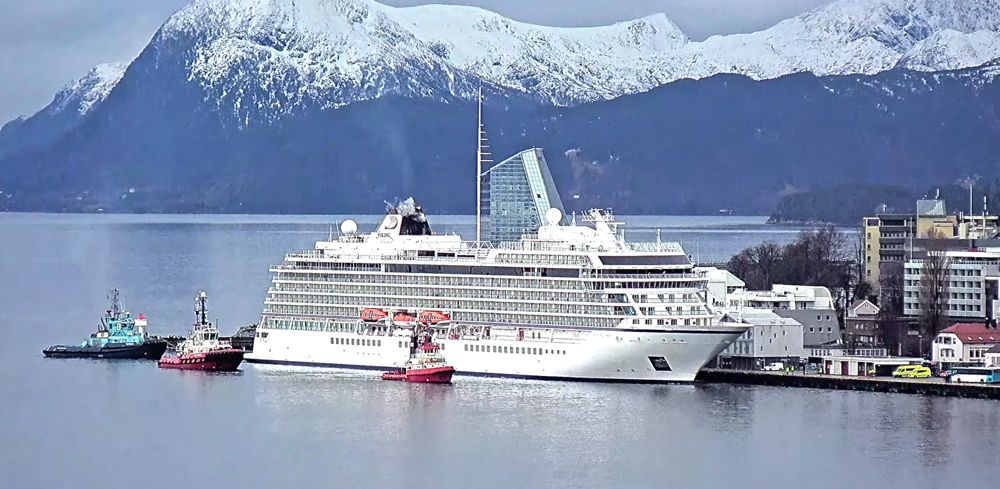

  6. AMG
    5,392
    She is now safe in the beautiful port of Molde...
