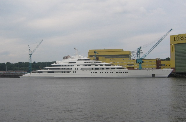

    B.t.w. as I am stuck in Hamburg for private reasons at the moment, my "standing orders" for the family apply. Any family member passing to the north of Bremen, make pictures of A&R or Lürssen, if nice boats are docked at the outside (My daugther and her husband live in Bremen).
    This is the result of todays photorun of my son in law to the Weser River:

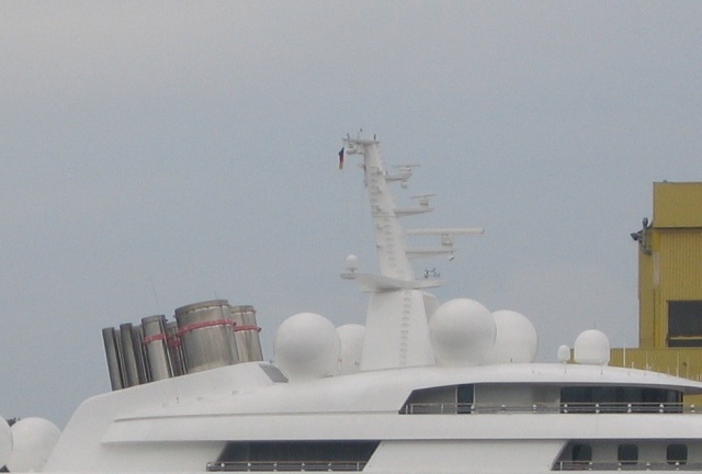

    Both yards were quiet, except Lürssen for this little white Yacht, moored at Aumund, which just came back from seatrails. On the second picture, you can clearly see the colour change of the SS exhaust stacks and the typical "dirty mast" problem of large yachts with dry exhaust stacks (like Topaz).
