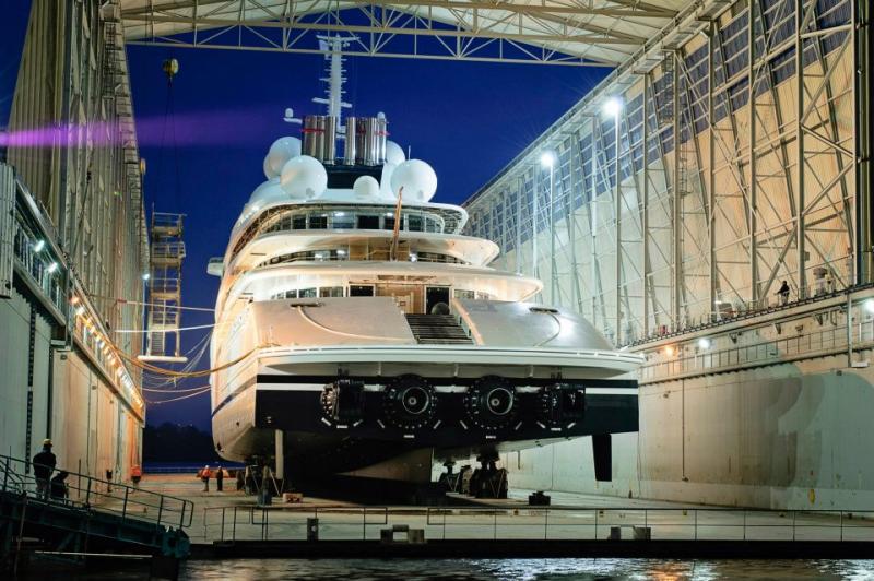

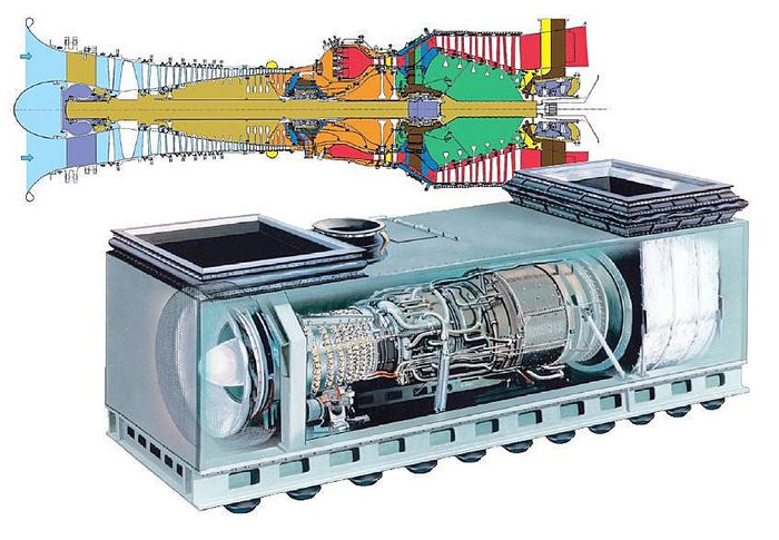

    The propulsion system seems to be a CODAG / CODOG type propulsion. 4 Waterjets concisting of two steerable units and two booster units. Looking at the exhaust stacks (perfectly designed and placed) I would estimate two big gas turbines (like the LM 2500) and some diesel propulsion engines. The smallest stacks at the rear probably diesel gensets. Cant see the air intakes jet, maybe in the main mast? This engine room needs a lot of fresh air!
    Interesting to see the (slow speed ?) rudders / stabilizers (?) under the stern. They look like the B&V Industry rudder/stabilizer system. As mentioned on this forum before, the whole propulsion system looks like one being proposed by B&V.

    But I believe they are needed. Those two GT convert some 20.000.000 cubic feet of fresh air per hour into exhaust gas. And this does not incude the need for the big diesel engines. If they breath ambient air from the engine room, there will be a nice draught in it. The perfect position and angle plus the length of the exhaust stacks lead to my assumption that there was some wind tunnel testing for this issue. They are located at the point of lowest pressure of the aerodynamic body (at 30 + X Kts).
    The design of Azzam is a typical example of a state yacht from this part of the world. And it is a full custom yacht. The owner gets what he wants.
    If the newspapers are correct, this yacht will mostly be used to steam from its harbour in the UAE to the beautifull resorts of the Seychelles and Maledives and back. If this is correct, and after looking at the FB pictures, the yacht must have some loitering or even DP capability. The B&V rudder/stabilizer system has no zero speed stab capability. They are high speed devices. This sleek high speed hull must have some rolling tendency. I believe that these openings mid hull below the waterline are retractable zero speed stabilizers. The absense of visible bow and stern thrusters is asking for some kind of retractable azimuth propulsion systems. Without those systems, a 180 Meter boat with only 2 steerable Waterjets would not fulfill the IMO/SOLAS regs for maneuverability.

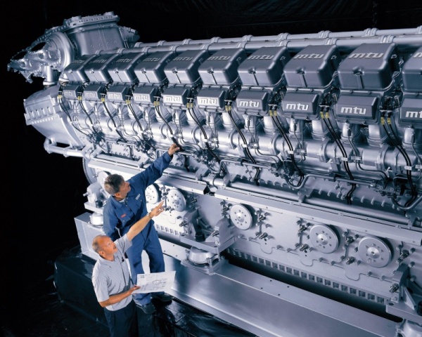

    If you equip your boat with 2 of those babys each, that will give you some performance at least.:)
    Copyright MTU/Tognum
