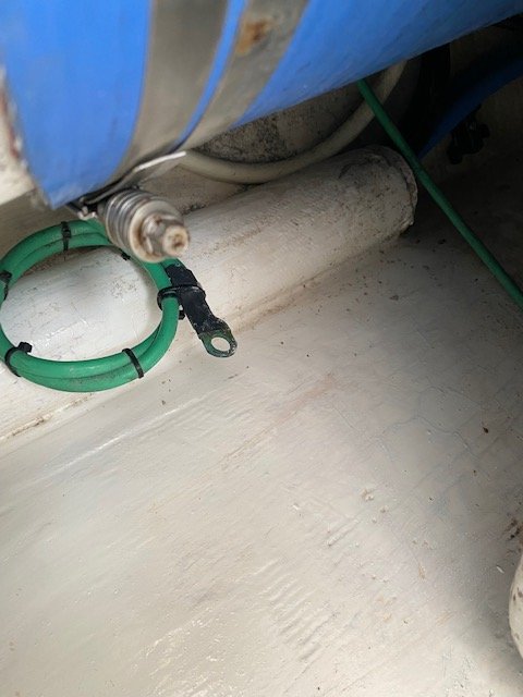

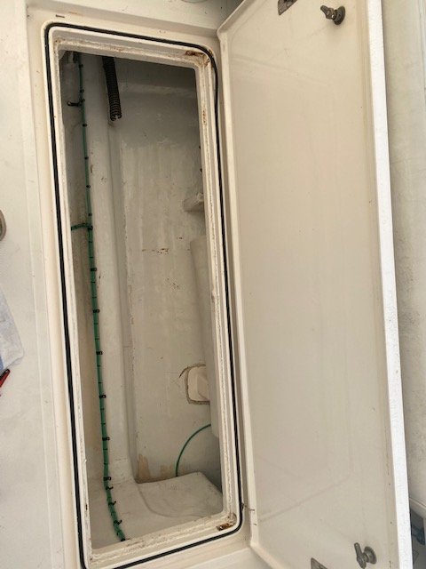

    Yes it was a silicone type caulking. It appears as though the port fish box was removed in the past as it came out very easily. After removal I could tell the exhaust silencer had been removed and re-installed, likely as interference to replace the hydraulic lines to the steering rams. Next to identify where this common bonding connection should be connected. I'm planning to install new hatch seals and new gas lift support struts as well.

    Cabo may have provided that for tower leg should a tower be installed after delivery.
