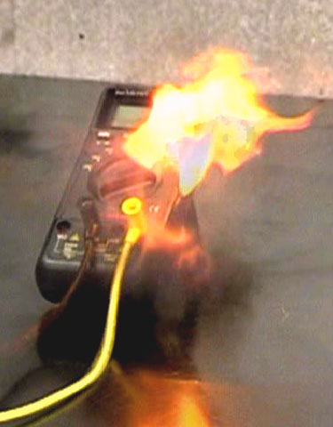

    Do a little bit of Googling for meter safety, arc flash, electrical safety. The history of cheap meter explosions, fires, and smoked amateur electricians is long and gruesome.
    When you discover that the probes are not long enough or thin enough to reach inside the shore power socket or female end of the cord to read a voltage, what is your next step?

  3. K1W1
    7,453
    Use those cheap test leads with an alligator clip at each end, one end on the probe and the other on something long and skinny enough to reach into the hole.
    Nails , bits of wire coat hangers, electrical screwdrivers all work just fine.
    The beauty of using those test leads in between is they form a sort of safety device in the event of a major over current. You can tell this is happening as the insulation really swells before they burst into flames :D

    Gee! I wish I knew that before I used a $20 voltmeter 1,653 times in the past...:eek:
  5. K1W1
    7,453
    The $20.00 Meter will probably be a world away from the Barbie Pink $5.00 one you linked to

    Don't worry ... there's always the next time.
  7. Capt J
    14,896
    Jeeeez Marmot, how else are you going to light the charcoal barbeque grill on the dock next to the power pedestal when the winds blowing????? And at $5 a pop, it's almost as cheap as lighter fluid in some places!
