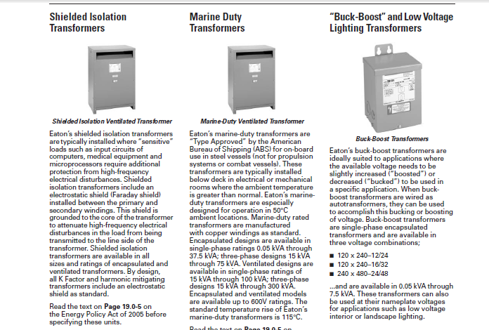

    The type of transformer that may be applicable to the issue under discussion (if the supply voltage is low) is a "buck-boost" transformer and like many other transformers, will most certainly have inputs that are electrically connected the output.
    Low voltage, dry-type, buck-boost distribution transformer

    From your link:
    Buck-boost:
    The name of a
    standard, single-phase, two-winding
    transformer application with the
    low voltage secondary windings
    connected as an autotransformer
    for boosting (increasing) or bucking
    (decreasing) voltages in small
    amounts. Applications can either
    be single-phase or three-phase
    Autotransformer:
    A transformer in
    which part of the winding is common
    to both the primary and the secondary
    circuits.
    The auto transformer has windings or plates common to the primary & secondary sides.
    Common windings does not mean connected or (tapped) winding, IIRC. This is the part that changes the ratio to boost or buck the voltage.
    I'll have to meter one to see if I can read a circuit (Polarity) from the primary to secondary sides of a non-energized one.

    Marmont your right on the auto transformer. :eek: but I didn't realize they are part of the buck/boost transformers. I looked for a diagram ,must have opened every pdf except the correct one.
    But why not install isolation ones? cost is probably a factor.

    Not all transformers isolate their primary from the secondary side!
    Enter the autotransformer. Yes, that means that you can electrocute yourself if you touch the phase (aka the hot lead) on the output on these.
    [Autotransformers are often used where isolation is not required because they use significantly less copper. They are smaller, lighter and cheaper. And guess what, a look at the technical data for the low voltage, dry-type, buck-boost distribution transformer linked by Marmot shows that they are autotransformers.]
    Normal transformers indeed isolate primary from secondary side. But depending on the application stuff gets tied together again, say connecting neutral to the same ground.
