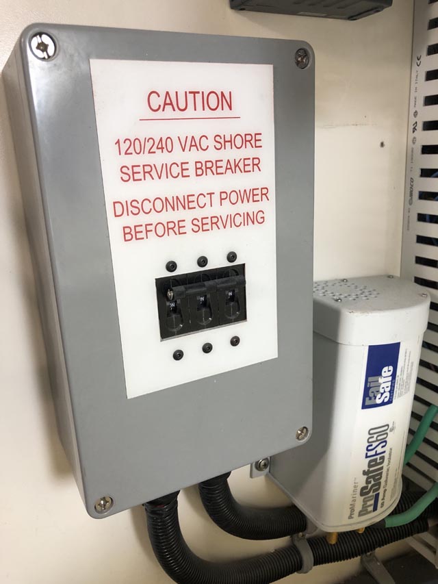

    I believe before but I'm not positive on that. Here is a picture if that helps.

    Cant tell from the pic but it's a nice clean installation FWIW.

    Based on the warning label, I'dbet on before the main breaker.
    However I'd like to think it's like my Viking, a breaker at ship entry, isolation transformer, then main breaker in master panel.

    The photo shows a triple breaker for the 120/240 supply, which would be Line 1, Line 2, and Neutral, ordinarily. There isn't usually a breaker for ground. A galvanic isolator is a simple device that passes the shore ground through a diode. The diode has a voltage drop of about half of a volt. The idea is that stray DC current entering the marina ground system from a nearby boat, won't find a path to the water through your boat and eat your zincs and other metals.
