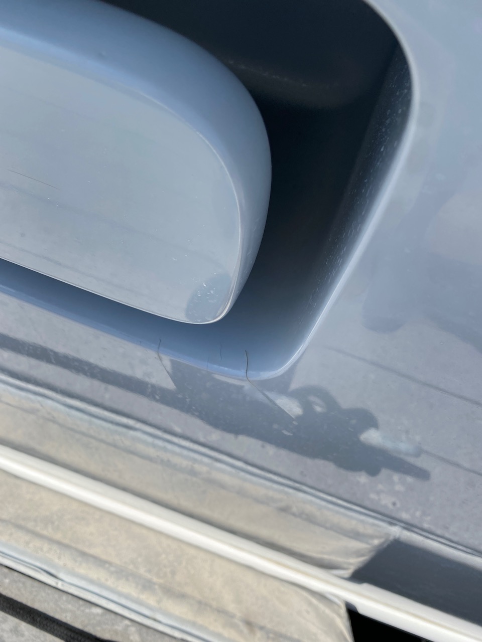

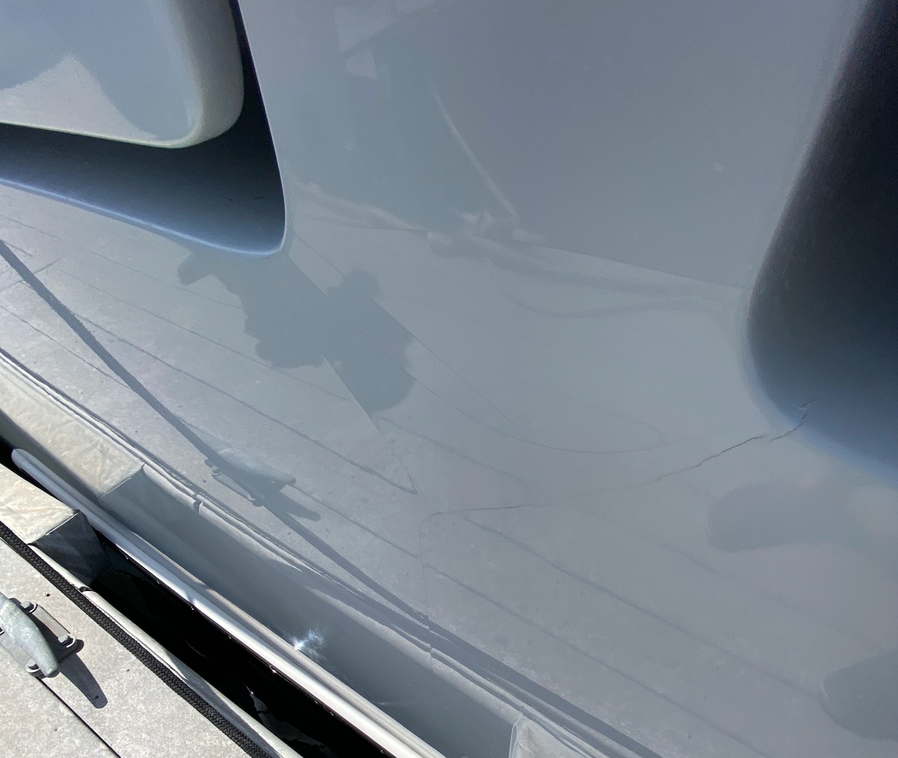

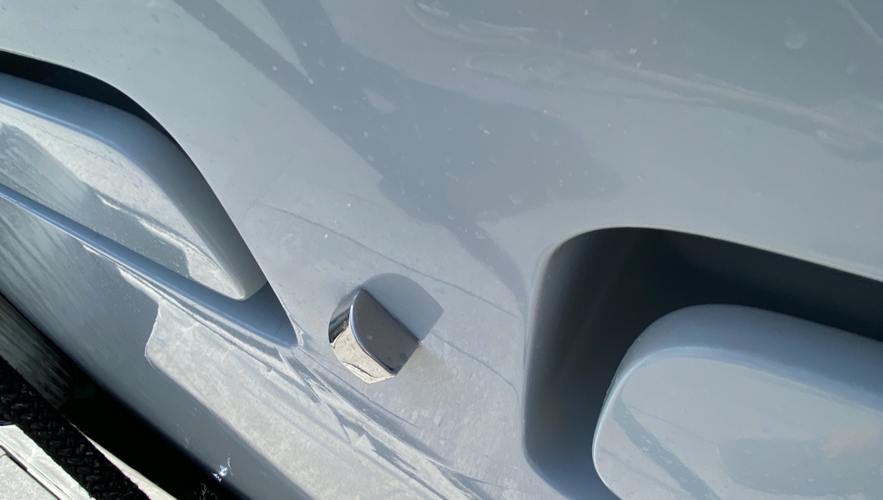

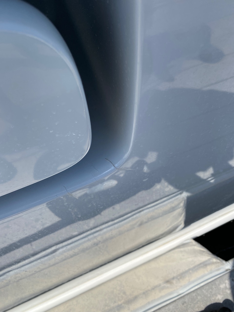

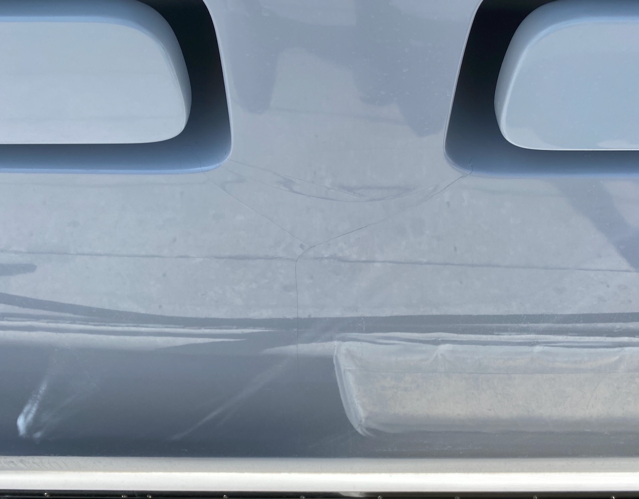

    Still looking. There's a boat the wife and I like, but it has issues with hull cracks in the paint (hull was painted over the gelcoat) that I'm not sure are significant. It's an OA. Apologies in advance for the barrage of pics, but trying to be thorough.
    Any advice?

    I don't know. Those don't look like I would want my boat to look like. Is that common with that era OA? It's a bit much for my tastes. If I were liking that boat otherwise I would get a proper shipwright to quote the proper repair for that and go from there.

    Used to seeing crazing, not that. Worried about it coming back after the repair.

    Gelcoat is most prone to cracking around tight bends, corners and areas that flex. Unless this area has been subject to impact, it looks cosmetic to me. Not a dealbreaker.

    Even if cosmetic, is this the kind of thing that'll keep coming back after repair?
