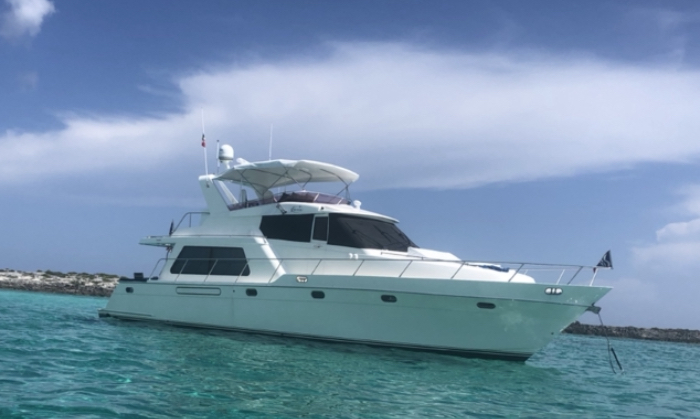

    I have a 2007 Pama 54Lx. These were built in China and I assumed they ceased production after the 2008 crisis. There are a several in Florida. I have Hull 11, twin Volvo D-9s @ 575HP. Great teak/holly interior, crane/davit with 13’ tender, 2 head, 3 stateroom layout (although the 3rd is a small bunkroom). I’ve added a water maker and am just now adding an ARG Gyro stabilizer. It’s great for ICW, Bahamas, Keys and great loop. I’ve put 353 hours on her since 2018....Not sure it would be right for Canada Alaska
    Pama62Lover likes this.

    Koffee--nice boat!
