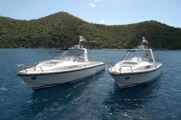

    Over the years we've used many different brands of tender.
    Boston Whaler (13, 15, 18, 19 and 25 footers)
    Zodiac RIBs
    Avon RIBs
    Cigarette (30 & 32s)
    Donzi (Sweet 16 & 18)
    Castaldi Jet RIBs
    On one boat, a 75m, we ended up making our own design of Aluminum tenders with twin Cummins and ZF outdrives. They were 'OK-ish' but way too heavy; ask K1W1, his team had to work on them.
    They have now been changed to these.
    Depending on how you use your tender I can only recommend a RIB with a big outboard, not an outdrive or jet though. Boston Whaler 2nd (Skiffs seem to slam a little) and just for the love of them, 3rd a Donzi, totally impractical but soooo beautiful.:D

    Good call, exellent boats. A sort of half and half answer. The trouble is they keep fitting Yanmars and Volvos in the stern. You only need an outboard; much cheaper, easier to work on and can be changed in a morning if needed. Plus they are sealed by their cowl against a flooding that can happen in big seas. Explorer Yachts are not going to ponce around in marinas and need tough workboats.
