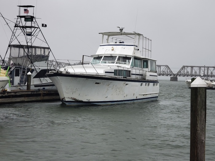

    <-- Our ole Bert.
    I feel like a heel dumping on you. Didn't mean to slap to hard.

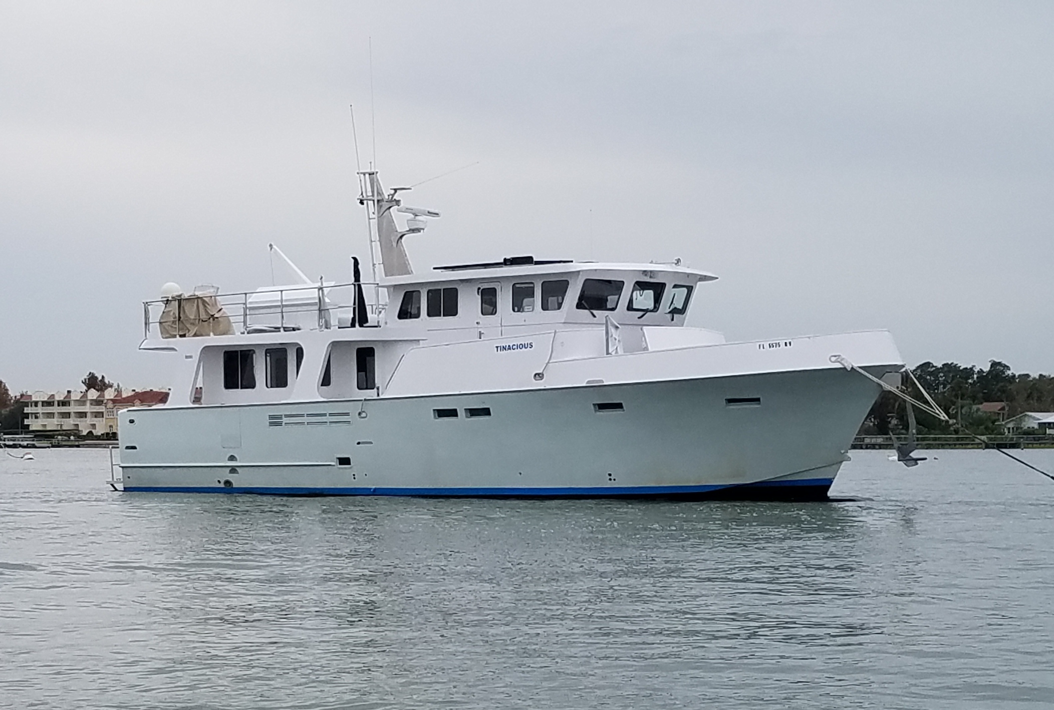

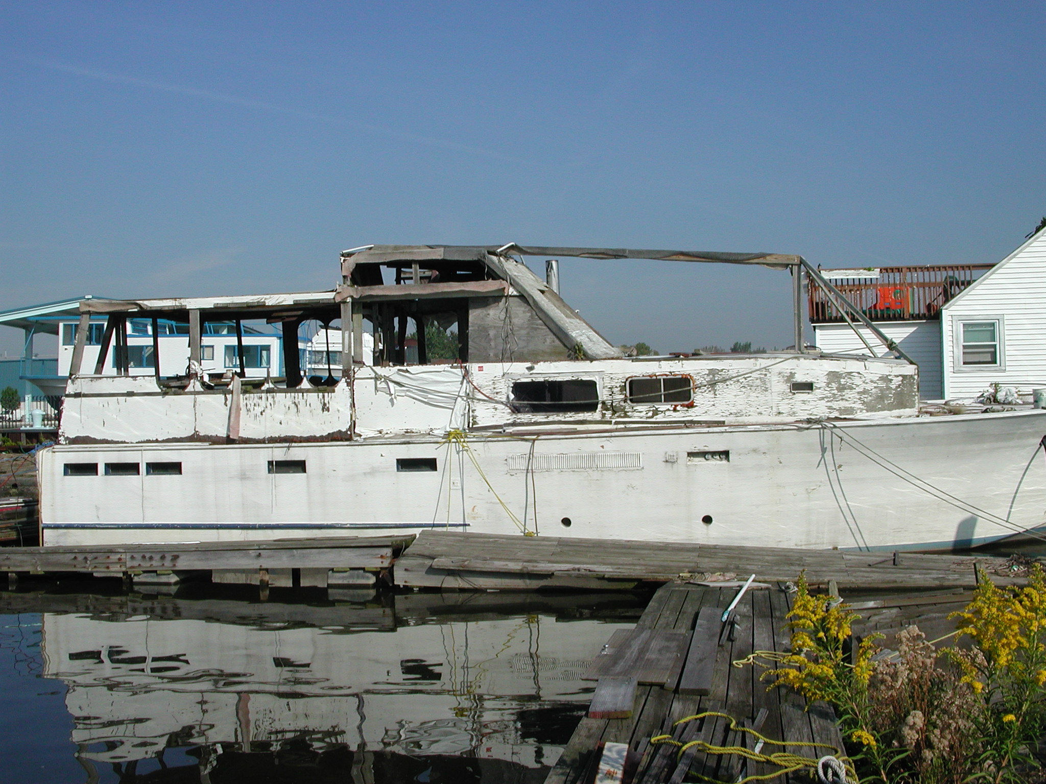

    OK, so you've gotten all the negatives. I agree with most but not all. You didn't say much about yourself. Mechanically inclined doesn't always match the project at hand, though it will help. Is that experience in boat construction/ maintenance? If you are not familiar with boat construction, don't be surprised if you have to do the same job over again. Next how old are you now and How long are you willing to commit? Capt J had the right idea but the wrong ratio. Its more like 98 out of 100 will never finish a project of that magnitude. I've been boating (cruisers) since the mid 70's, owned a marina in the 80's and have seen these projects languish in the 'bone yards' of many marinas. A wise 'project guy' advised me "Make out a budget. Be sure to include everything you want to add or change. Be generous, things are never as cheap as you think. Total that column. NOW DOUBLE THAT ! !" Wait, we are not done. Now put together a calendar. Are you working on it year around? Just on weekends? Do you have to drive to the project. Add all that time up. NOW TRIPLE THAT !! " He did finish his project and cruised the Caribbean. I saw his boat listed a couple years ago. So he cruised for about 12-14 years.
    So you think you'll be done in a couple/ three years. Are you prepared to commit 9 years?
    I know from wence I speak. Our 58 aluminum Roamer took ten, yes count 'em, 10 years from strip down to launch. We have been living aboard since 2015. It took just under twice my calendar projection and just under twice my original budget. And that was in our back yard! $9 boat units to truck it in and $6.5 boat units to truck it out. That was part of the planning budget. But we are part of the 2%, and happily cruising the waterways from the Great lakes to the Bahamas.
    So if you think you can beat the odds, go for it. These boats have good bones. If it was in fresh water, the 'thin tin' concern is less of a worry. We only replaced the after-most two feet of bottom and the 'V' struts. That's where the props ate away some aluminum (galvanic action). The bottom is 3/8 inch plate, it's not a sheet-metal boat. But the decks are plywood under that teak veneer. If you have deck leaks, anticipate major surgery. This is where being mechanically inclined meets boat building nightmare if you want to do it right. Not just a patch.
    So there was another pile of negatives. But . . . if you are young enough, clever enough, and can buy this boat for a song (say less than $10k), then prepared to spend a truckload of $. Heck, go for it. God loves fools and dreamers.
    then 2004 040730 at NJ dock - Copy.jpg now 20191018_171136.jpg It can be done.

    Holy Crow!!! That was like an Atomic explosion response to the OP! It's all laid out for you now !
    Wow boat looks great what a job! And lucky you, you get to use it the way you want. Great job on all of it and your travels.

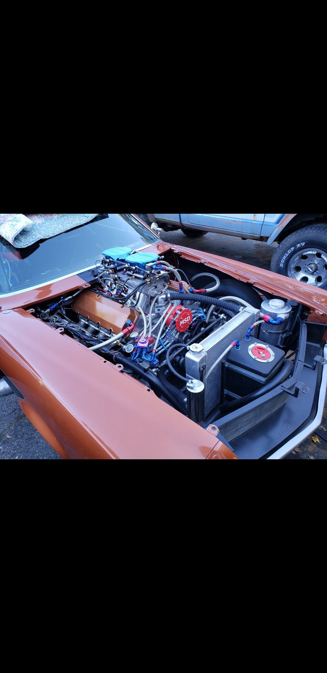

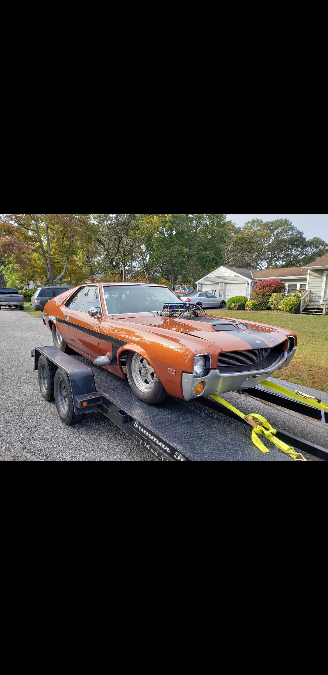

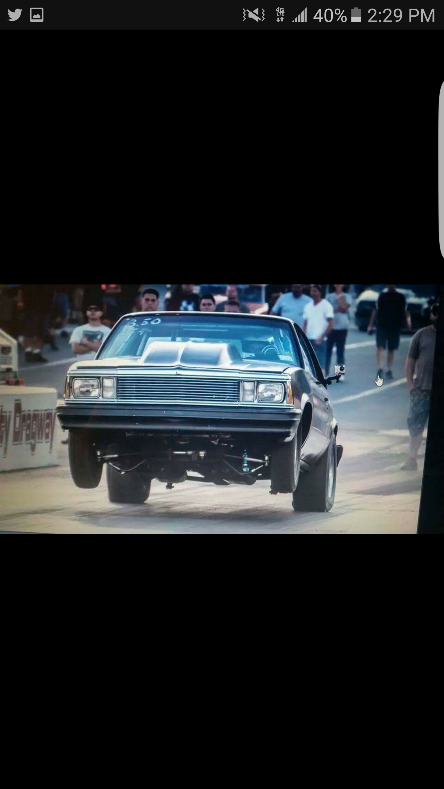

    Lol it's OK. And I appreciate the responses. Just some info about me I'm 42, I run a structural steel company that makes sign structures for the state of NY , I also spent many years designing and building hydraulic power units for nasa, the govt, military, theater industry, and many other large companies. I am a certified welder as well as an aws certified welding inspector, I can program and run cnc machines as well as manual, I can design in cad and solid works, I have done many large electrical panel layouts and builds, wired buildings, some houses etc. However my real passion is not only boating but drag racing I own and build high end drag cars, some with well over 3000 horsepower lol. I build chromoly tube chassis cars from the ground up. I build the engines, wire them, machine my own parts, and have even painted some as my uncle owns a large body shop. That being said I'm no stranger to anything that that boat would need. Just was a matter of whether or not it was going to be worth the effort and money. FYI I was going to buy it for ten grand. So I honestly figured I could get it painted by next summer if I kicked ass on it then chip away on the rest of it while using it. I know it would take many years of work. Hell I completely redid my carver 3207 over the past 9 years and I still fix stuff every time I'm out on it lol. It never ends. I just wanted to at least let you guys know I'm not some knucklehead dreamer that had unrealistic expectations. And I am quite capable. But your right. 1, it's too much boat for me size wise, 2, it's too far gone I think. At least for me, 3, I think I would be better off with something 40 to 48. I really do appreciate the feedback from all of you. That's why I asked!
