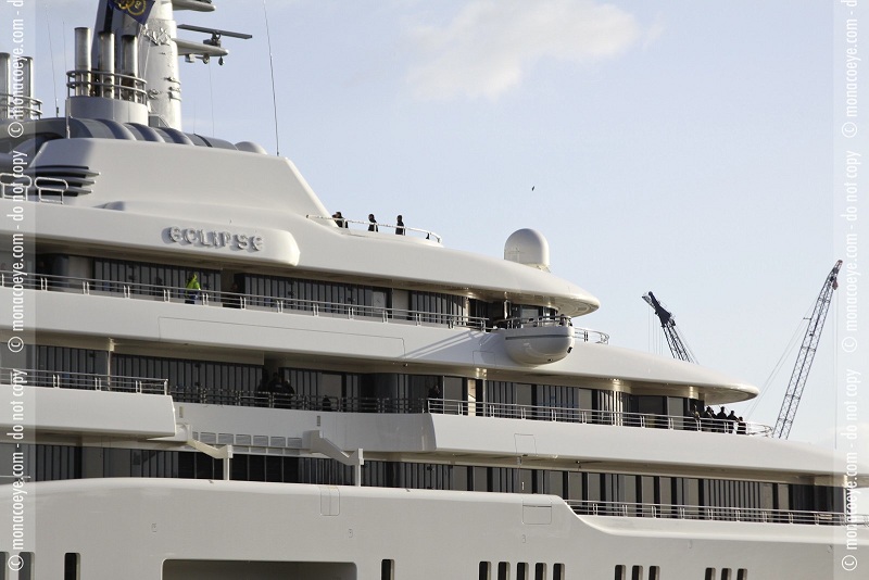

    Thought I would start the old thread back up again with a similar, but bigger question, this time in relation to "lifeboats".
    I've been looking at Eclipse's 13m lifeboats that she runs at her midships (both sides), and I need to know how these boats have to be operated...?
    My thought is they can be manually winched in, and/or simplely the cradle can release the lifeboat by rotating/pivoting and releasing the boat straight in (big fall)...?
    Is it also true that a lifeboat has to hang over the gunhale in such a manner that the above actions can be done, or is this a myth and a lifeboat of this size can be stalled inside a garage.
    Would love some pointers, thanks.
    Far
  7. K1W1
    7,453
    Lifeboats will normally be davit launched although there are also the Freefall ones usually found at the stern of the ship.
    There are rules and regulations as to how many have to be carried and at what angle of heel they must be able to be deployed, the recent Costa Concordia sinking will no doubt be causing a rethink on this one.
    I have not seen any carried inside as yet but given the wildly differing interpretation of the same written rules between Surveyors anything is possible.
    You might get a few answers by reading this: http://www.maib.gov.uk/cms_resource... lifeboat_and_launching_systems_accidents.pdf
  8. 84far
    84far Senior Member
    Dec 15, 2008
    794
    Brisbane, AUS
    Thanks K1W1, Some light reading for me :D
    I did notest the tankers ran the lifeboat from the stern with a majority running a freefall release. But as this is a pleasure vessel, I might have to stick to the midships.
    The attached image is Eclipse's layout - I'm guessing, but there seems to be a trap door above where the boat is kept, would this be where the cranes/winches a located...?
    Far

    Is is not required that lifeboats hang over the side of the vessel. Free-fall lifeboats are only allowed on cargo vessels.
    Passenger ships (& by extension passenger yachts) are all davit launched & are required to be capable of being launched against a 20 degree adverse list and within 30 minutes. There are many other requirements as K1W1 mentioned including minimum height above the water line and an easily accessible & protected muster point for guests & crew.
    If a yacht is also classed as a passenger vessel then it is highly likely that her lifeboats will serve a double function as a rescue boat, (here I refer to a true SOLAS rescue boat & not the simple inflatable rescue boat required by LY2). This brings many further requirements including a launching capability in 5 minutes.
    Therefore it is unlikely, but not impossible, that a lifeboat would be stored in a typical yacht garage.
    I do know of one large yacht under construction with gull wing doors that will totally hide the lifeboat. The entire launching process, including opening the doors, is carried out using gravity/stored hydraulic power. It is a relatively simple matter both technically & design wise to do & I suppose hidden lifeboats will be a trend on future projects.

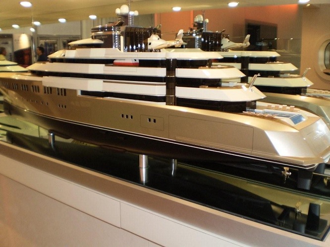

  13. 84far
    84far Senior Member
    Dec 15, 2008
    794
    Brisbane, AUS
    Are you talking about Oceanco, I believe one of there designs (attachment below), has the Lifeboat packed away to keep it decrete. As you can see, not totally covered up, but enough to know it's there, just what the doctor ordered.
    To the drawing board! :rolleyes:
