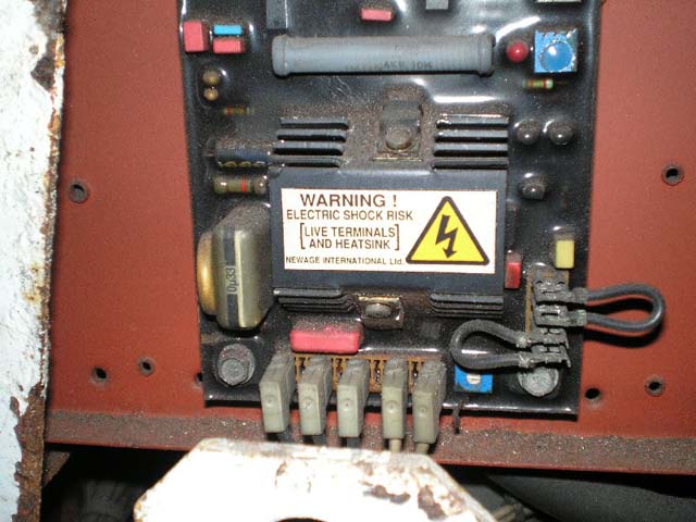

    I have Kilo-Pak 60 which has been inactive for 3 yrs. The J-D runs fine but shows no life from the important end.
    I'm told I can excite it(takes all kinds, I guess) but can't identify anything marked F1 and F2.
    The circuit board at the end is the Volt. Reg. I guess.
    Any ideas??

    I would expect anything marked F 1 or F 2 on an electrical drawing to be Fuses. I do not see any fuses in that photo.

    No fuses, no breaker on this Baby. Just got a wiring diagram from K-P, so lets see what that does to help.

    What protection does it have for Overcurrent?
    Looking at that photo what appears to be metal bits in the dust could be some of the reason it doesn't go

    Those 2 Black U shaped wires in bottom right may be "fusable links" a specfic type of wire to blow @ a set amperage. I'd check them for electrical continuity . I don't see any other reason why they would be there.

    F1 & F2 on the drawing are generally field wires, identified because of the need to excite the genny via that wiring.
    The black wires are jumpers, likely for different voltages.
    As to why the genny doesn't produce power, that is a more complex issue. I would definitely excite it. You need to read the instructions carefully to accomplish this correctly. If that doesn't work, checking the Voltage Regulator is next. Bad diodes there can be easily fixed. Replacing the board if other components are bad may be necessary. Checking continuity on the rotor and stator is easy and should be described in the manual. If either is bad, a new gen end is warranted if you are going to fix the genny. Most people warn against rewinds of any sort.
    Newage is an excellent gen end and many techs are familiar with it. They are called Stanford Newage now and very good.
    Believe it or not, if it has been sitting around and is damp and it excites, the manual may allow shorting the output and starting the generator for maybe 30 seconds. That drys windings and is a standard procedure on some gennys shipped from overseas on boats.
    Don't waste time looking for fuses or breakers. If they are there and there likely are none, they will be obvious. Gennys are like transformers, shorting the secondary will not fault the primary, they simply melt down.
    That is about it. Good luck.

    I asked a mechanic that question a while back while as he was working on my gens. A previous engineer was telling me he had to excite the coils some times on this one gen. The mechanic told me that if you need to excite the coils then you have a seriuos problem, like a failure in the winding insulation. The charge had to go some where and where did it go and how? He thinks the previuos engineer lied to me. The mechanic said that you would have to excite the gen each time if it was loosing it's charge some how..

    my Norpro 18 uses a Marathon Alternator, its manual has a procedure to flash the windings on initial install or whenever needed. Never had to do it but maybe something that needs to be done after log periods of inactivity? not sure if it applies to all alternators or just to that specific type.

    The WARNING says it all. Recommend you turn this over to a marine electrical engineer.
