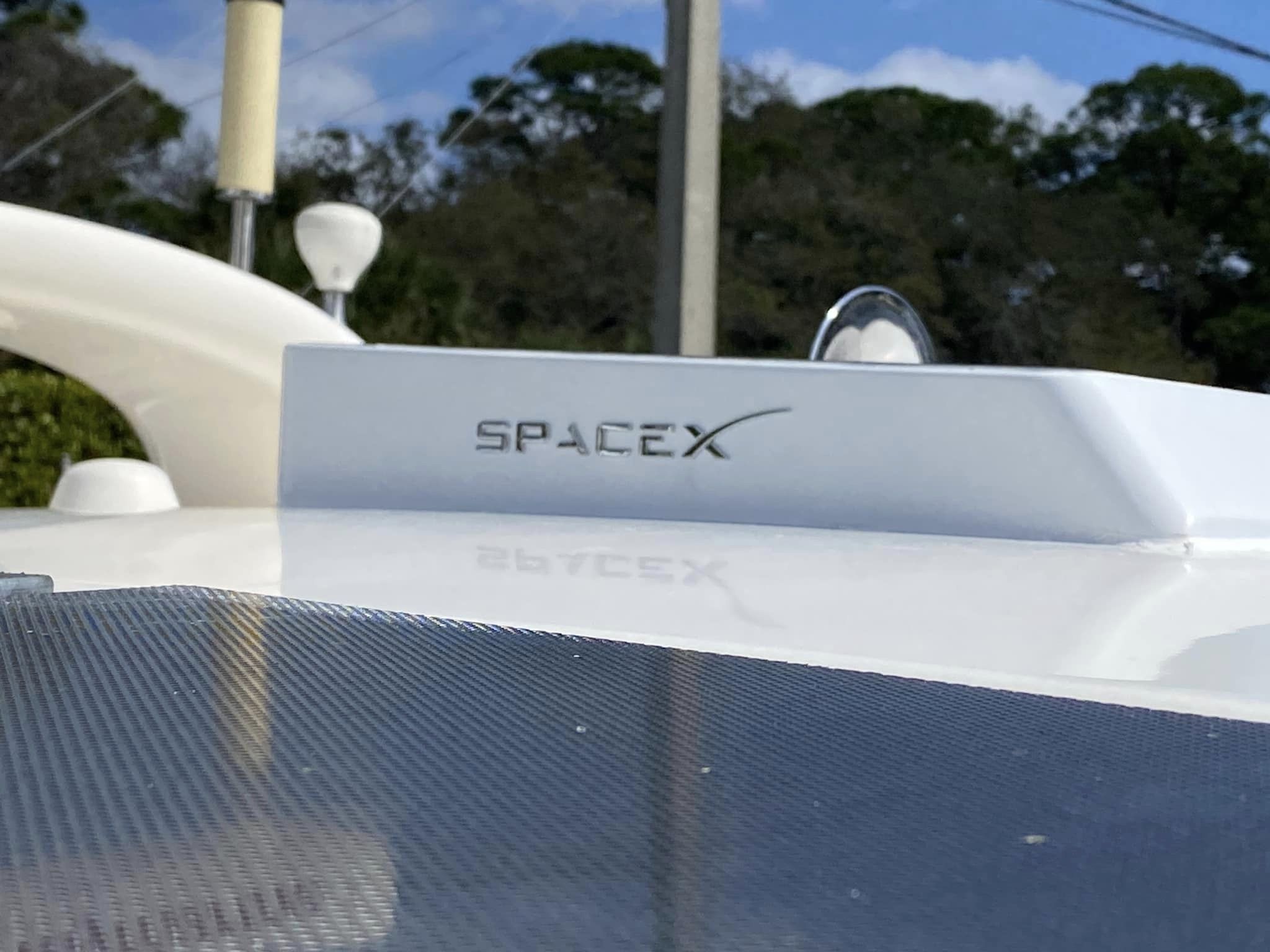

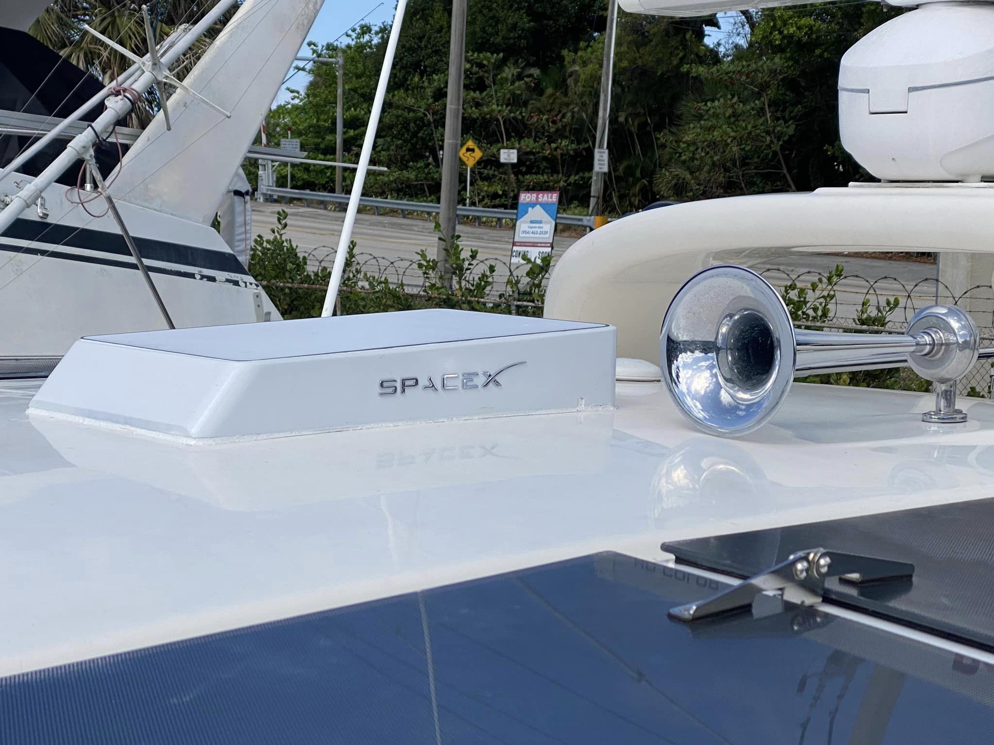

    In a Facebook group about Starlink on Yachts there was a post about standard RV version, that got 'freed of motors', but still waterproof by itself and slightly sloped so the water goes off by gravity, therefore a bit taller than the version from Post #17. Idea is from Everlanders and the models of 3D printed pieces are here. Somebody may find that helpful.
    Photo: Grant Johnson
