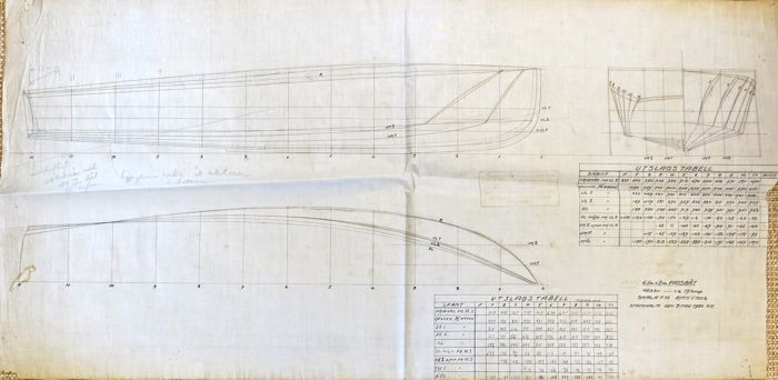

    I think this way of counting backwards from a 0-station is inherited from when drawings were with ink. Today when most of us use a computer, it takes one second to move and rename any position or number of positions so you get a proper drawing also after the adjustments. Since we are so far off topic anyway, here are pictures of original drawings I got last week for my oldest boat, designed in 1930, delivered in 1931...
