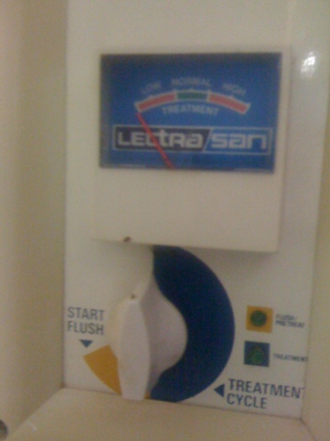

    Electra-San is not the make of your head. It's the make of the treatment
    system.
    http://www.raritaneng.com/products/waste_treatment/lectrasan.html
    Can you discribe your head? Or better yet, post a picture or two of it. If you really are pumping into a holding tank I would stop using the head till you figure the system out.
    Are there any manuals on board at all?

    As bill said lectra San is just the treatment system, illegal in some areas nowadays. Note That if your heads use fresh water you need to add salt for the LS to work

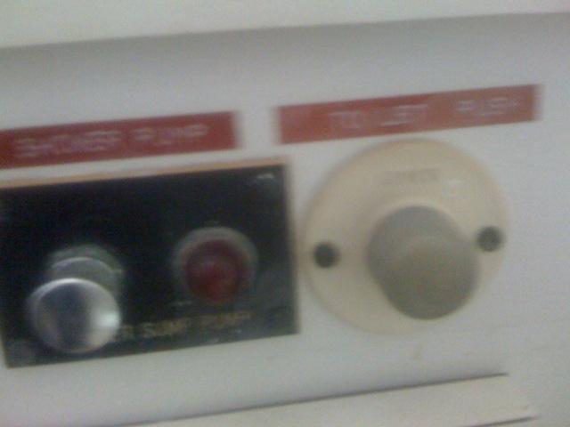

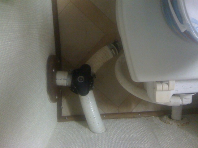

    Have attached pics. We'll see if they come out.
    Having difficulty getting info regarding emptying waste. My marina no longer has pump out. Next closest one has slip too narrow to accommodate.
    Thanks again.

  10. SeaEric
    SeaEric YF Historian
    Jan 28, 2007
    1,380
    out on the dock
    Looks like a "Y" valve on the discharge of the head. You're going to have to trace the plumbing and see where those hoses go. Are the choices treatment and holding tank, or treatment and direct overboard? See where those hoses go after the "Y" valve.
    Is there a deck fitting anywhere marked "waste" ?
